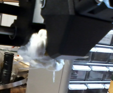

Greetings all! Was printing up a circuit box for a friend’s Raspberry Pi kit. Said print should have taken close to four hours. I left it alone after it started alright, but when I checked on it a couple of hours later the plastic had all wrapped around the heating element and nozzle! It’s a solid chunk now and if I try to pull on it, it just moves the entire printing head. I have a Monoprice PN15365 printer. This was only my third print (have two of the cats test prints that come with the printer). I bought the machine new, even though its an older model. Any advice will be greatly appreciated! Sign-- Wacky

While it looks frightful, that kind of mess is pretty easy to clean off. Heat up the
hot end, maybe 150c and pull the plastic off with a pair of needle-nosed pliers.
It comes off fairly easy.
But… it might be a good time to pick up a spare hot end assembly. You
can get E3D clones for under twenty dollars. It’s a good idea to keep a spare
hot end.
Good luck!
Do you think that’ll work? When I said “encased in plastic” I mean the hot end has about a centimeter of plastic around it. :stuck_out_tongue: The material was pretty malleable due to the platform being heated and so early in the molding stage by the looks of things. So I imagine that’s when it wrapped itself up like that. But your suggestion has given me an idea; maybe I should take a hair dryer to it (barring that my father’s heat gun) and warm up the filament to a softer state. Was just worried about harming the nozzle or wiring if I did that. Thanks for the advice!
Yes, a heat gun or hair dryer can work, too. But, heating the hot end, not too hot, works too.
Actually, it’s one of the more satisfying things to clear. :slight_smile:
Good to know. I’ll give it a go either later today or tomorrow. Thanks for the advice!
I would recommend keeping the heat gun nozzle a bit away from your target area and keep it away from the wiring. You may wish to use some aluminum foil as a heat shield to prevent melting anything you don’t want melted.
In the end I decided to skip the heat gun idea; I first tried the blow dryer at maximum power, but it didn’t do much. It DID show that the air when everywhere and I couldn’t control it. Next I tried my hot knife for cutting styrofoam. It was marginally successful, so I moved to a soldering iron at 16 watts. That was better but still not enough. In the end I went with a 25 volt soldering iron and that was much more effective. As the filament bubbled and smoked (lots of smoke, used an air filter next to the printer to keep in all in check), the plastic changed where the tip went but didn’t melt. After it cooled I could pull a good portion off by hand. After an hour’s worth of work I had half of it gone. I plan on removing the second half later today and giving it another test print. Thanks for the advice about the aluminum foil–that’s a great idea for future projects where I need to use something hot in a confined area.
