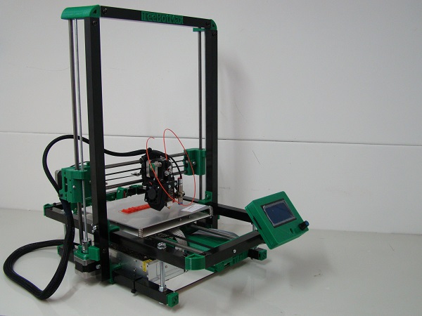

As mention earlier, best is to source all the parts your self choosing the best that is available and compatible. If you consider other design/option try “TeeBotMax & TeeBot” which are rep-rap styled 3Dprinters . what you get in addition is a taller build print of 25 cm, and a fold-able 3D printer. Kits comes default with MK3 aluminum heat bed and E3D lite (not rated for 300 degrees) as mention E3D V6 will be your choice for hotend, I am sure that can be arranged. You can also opt for TeeBot 26which is smaller and also defaults with MK3 heatbed and E3D lite. Both printers are within your budget. see the webstore www.3dstuffs.nl 46

The TeeBot looks interesting, but really I have no need for moving the printer around. I’d be more interested in the TeeBotMax, but I didn’t see anything on it listed on the TeeBot site. Also, I’m not interested in funding anyone on KickStarter due to the many stories of people investing their money to only end up waiting for months/years and getting nothing in return. While that isn’t tru for all KS companies, I don’t have the money to gamble with. Besides, I like the security of Paypal just in case I get something broken or different that what I ordered.
