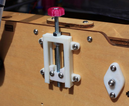

The most popular hack for an Ultimaker Original is a printable Z stage calibration tool that helps you level your bed very easy.

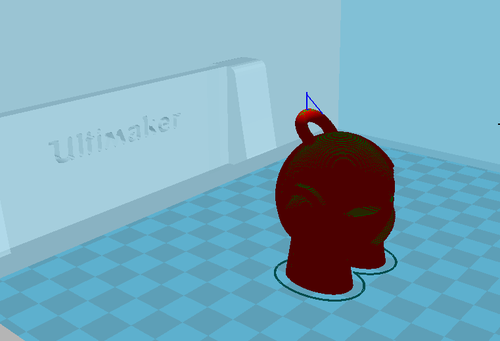

Brim
A brim basically is multiple skirts, all the way until they line up with your footprint. This enhances adhesion without leaving any marks on the print. This is a great weapon of choice to counter warping without leaving much scar on your print. Most objects will stay put with this big layer around the print, it’s also great to keep objects with a small footprint from tipping over. Again Brim can be tweaked from the Expert Settings, standard is 20 layers.

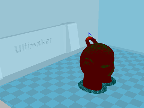

Raft
A raft does the same thing as a brim, instead of stopping at the perimeter it goes on underneath the print. The print is being build on top of this raft. This can help when you want to fight warping. However it does leave a mark on your print. You can play with the settings of your raft to fine tune it to your liking from the Expert Settings.

Using the brim is almost mandatory for large prints, specially during winter. However, it should be noted that brim can affect prints with holes in the bottom (see attached files). It can be easily removed with a sharp knife or cutter, but it might leave marks in the print. Sanding it with 320+ grain sandpaper and a drop or two of oil is an excellent way to remove it.
