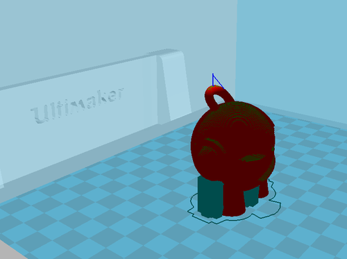

Using the brim is almost mandatory for large prints, specially during winter. However, it should be noted that brim can affect prints with holes in the bottom (see attached files). It can be easily removed with a sharp knife or cutter, but it might leave marks in the print. Sanding it with 320+ grain sandpaper and a drop or two of oil is an excellent way to remove it.

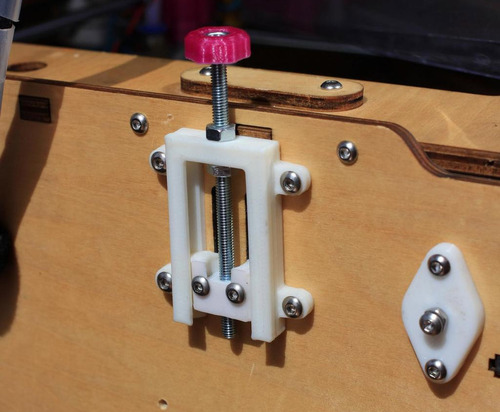

Additionally, replacing ultimaker 2’s feeder with this alternative version 12 is a great idea. This feeder allows you to quickly change filaments in mid-print (for multicolored prints), is easy to clean and see what’s wrong with filament jams.
If there’s one thing that I’d recommend it’s not to treat Cura as if it’s a “Drive Through McDonalds” experience where it’s just a quick place to pass your model through before printing. It’s actually more like a high class a la carte restaurant where you need to sit and spend time studying the menu properly to get the best printing experience. I would recommend going into the layer view and reviewing the layer stack before you print, that way you can often spot potential printing problems before you even switch on the printer. It’s far better to spot the problems before you start, rather than 6 hours into an 8 hour print.
A little time spent looking through all the options in Cura can sometimes save you hours in the long run.
Also I would recommend thinking about whether the model actually needs any infill at all, don’t automatically default to always printing with infill. I have made many models without infill because I’ve looked at the layer stack and seen that they don’t need that internal support. If that’s the case but strength is the reason why you’ve selected infill then it is usually more efficient in printing time to double the shell thickness from 0.4 to 0.8mm instead to make sure the model is strong enough.
