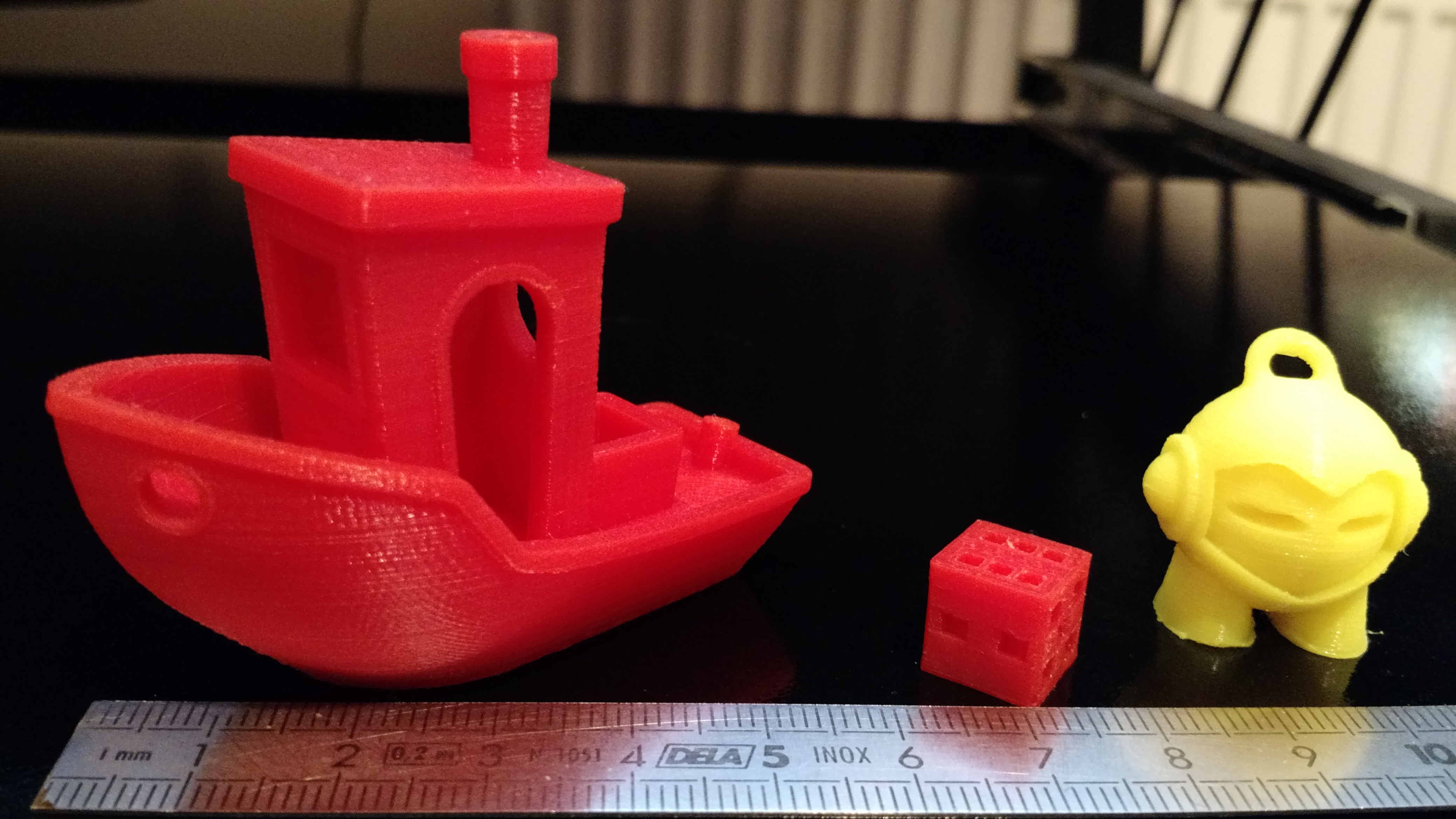

Hi, I’ve seen a few printers in my time working with them and noticed some kits can be better than prebuilt printers if you have a tiny bit of common sense. The nicest printer I’ve used is probably the prusa i3 original unlike the variations it can print a multitude of materials and has has a layer height as small as 10microns. However, when printing at that small a layer height I noticed the 0.4mm nozzle was a decent size too big, but I digress, in terms of print quality it’s better than the maker boys I’ve used and they were the more expensive models which names I do not remember (they were £3k and £5) Picture has a 100 micron 3Dbenchy and Marvin and a 10 micron dice Tl;dr prusa i3 original was pretty good 8.5/10
Has anything ever broke for you? What are common errors you have had or is it just the normal 3D Printer issues?
