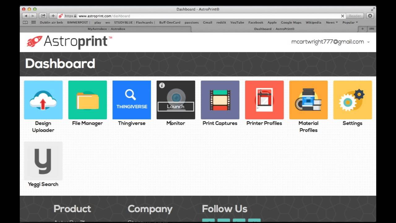

Here’s a quick little video we shot to help out with the starting process of the AstroBox and the 3D printing capabilities it has to offer! This time, on a Creator Pro.
For more information you can go to https://www.astroprint.com

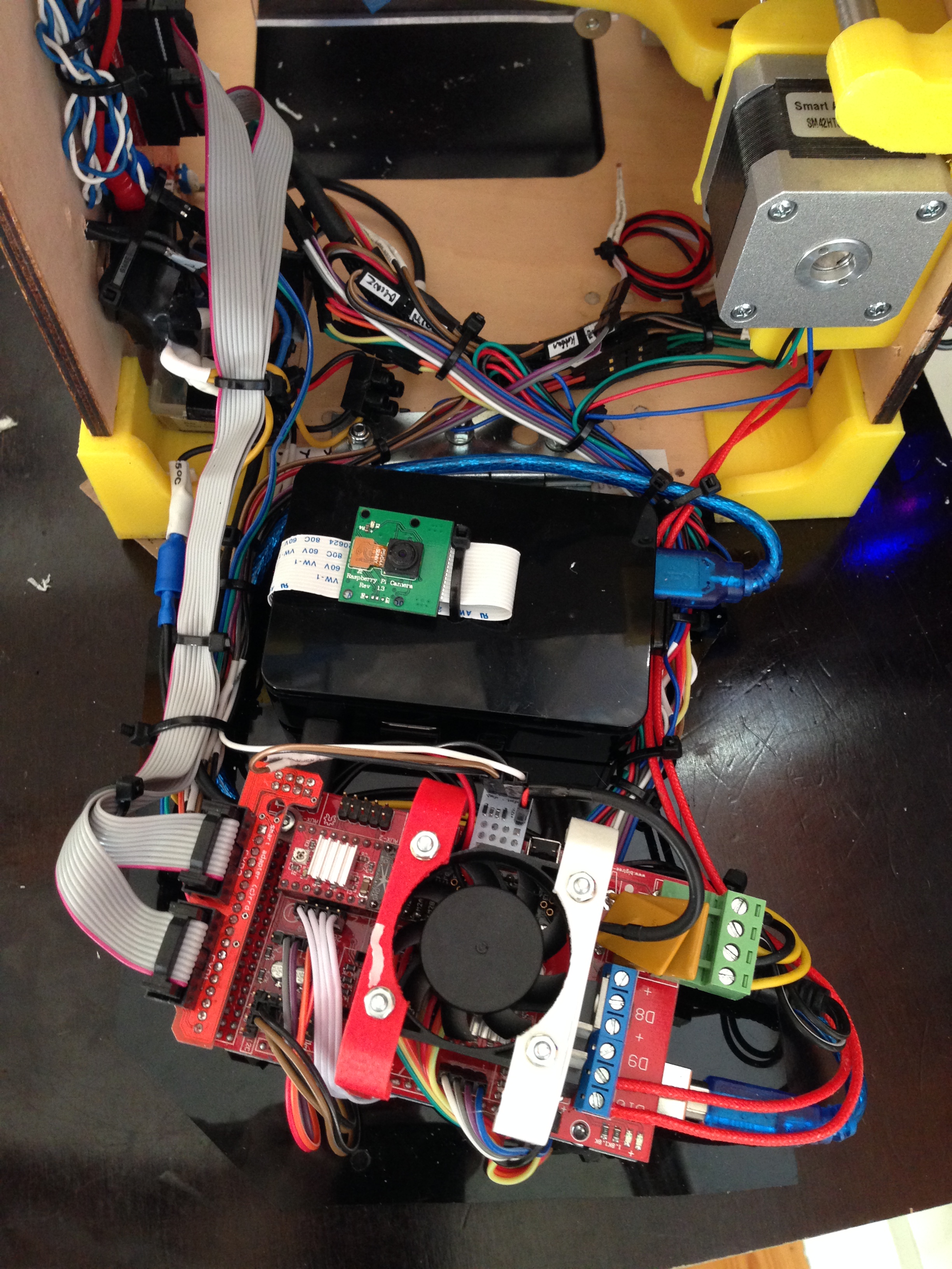

Try looking at the Photo I attached. The powerwires, signal-wires and USB are routed right along-side each other. It will be the same in many printers due to size-constraints and a wish to keep it neat.
