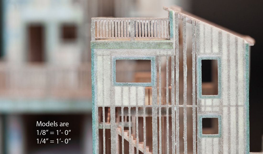

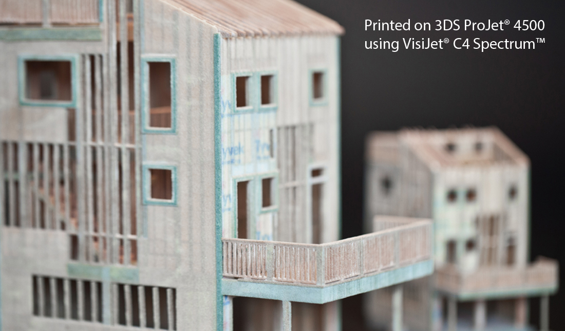

When I print architectural models on my ProJet 660 I try to design the walls so that they are larger than 1/16" thick. At this scale they may become fragile and actually end up being slightly translucent after the ColorBond infiltrant. Some examples; https://3dprinting.microsolresources.com/2015/02/06/3d-printed-gallery/ 1 The white floor plan model in this gallery link above is at 1/8" = 1’-0" The thinest wall is almost 1/8" thick.

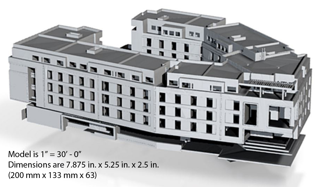

It all boils down to the scale of the model. All machines have tolerances for what the thinnest wall is. I have successfully printed models with a scale of one inch equals 30 feet. I have also printed a few models at 1/4" = 1’-0" and 1/8" = 1’ -0"
The larger the model the higher the cost. If you would like me to review your file for its printability I can take a look and advise you what your options are.

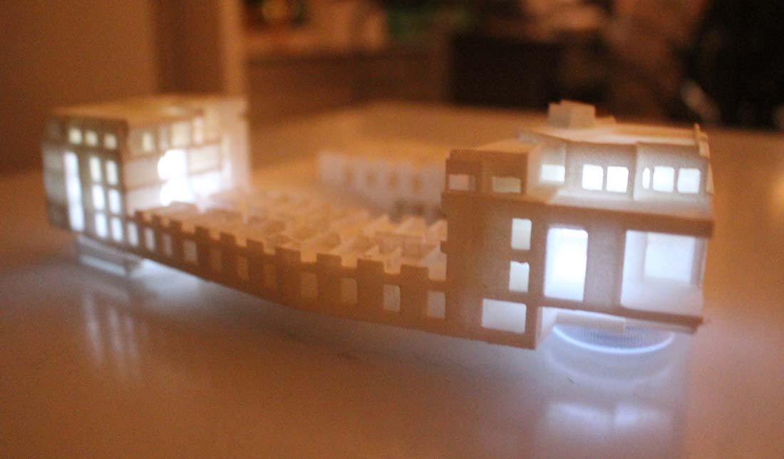

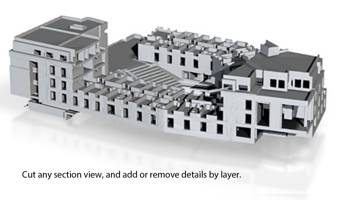

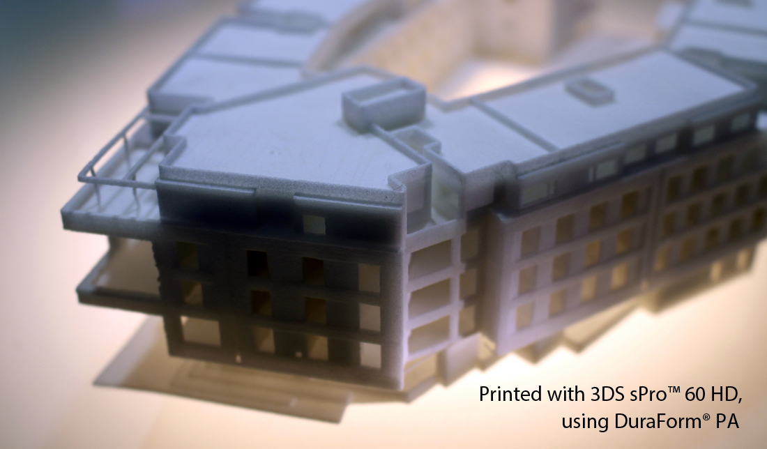

With SLS, above 2mm, any wall is really solid. The Polyamide 12 is translucent under 2mm, so even the glass of windows can be 3Dprinted thinner to show by translucency when backlit. The second picture attached has solid walls as thin as 0.4mm (400microns) but they are supported all around and are not longer than 10-15mm.

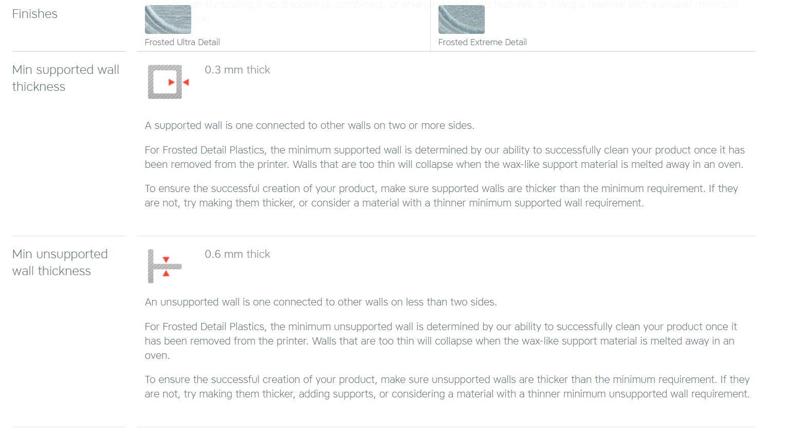

Wall thickness is limited by the dimensions shown in the printer information. This machine has a .3 mm tolerance for a supported wall. That is really detailed.
