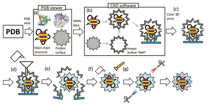

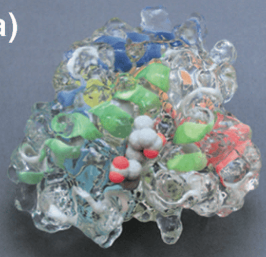

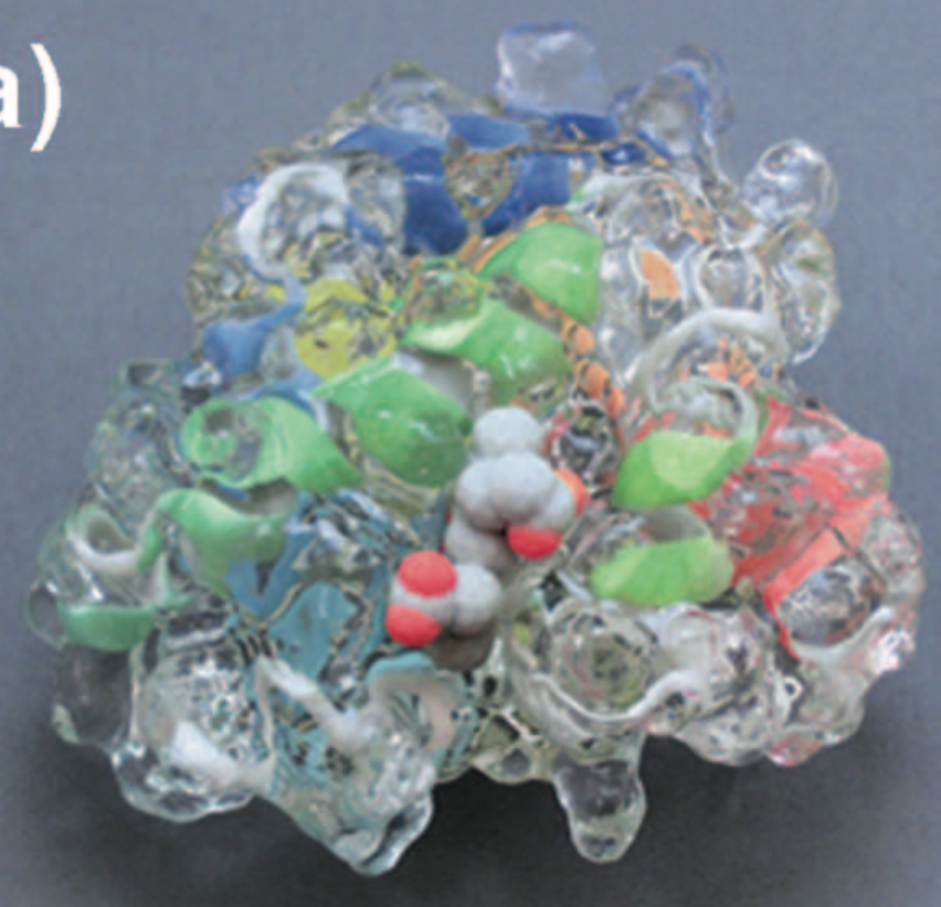

Kawakami is a material scientist who created amazing protein models that show both the interior and exterior structures using a full color print and silicone, respectively.

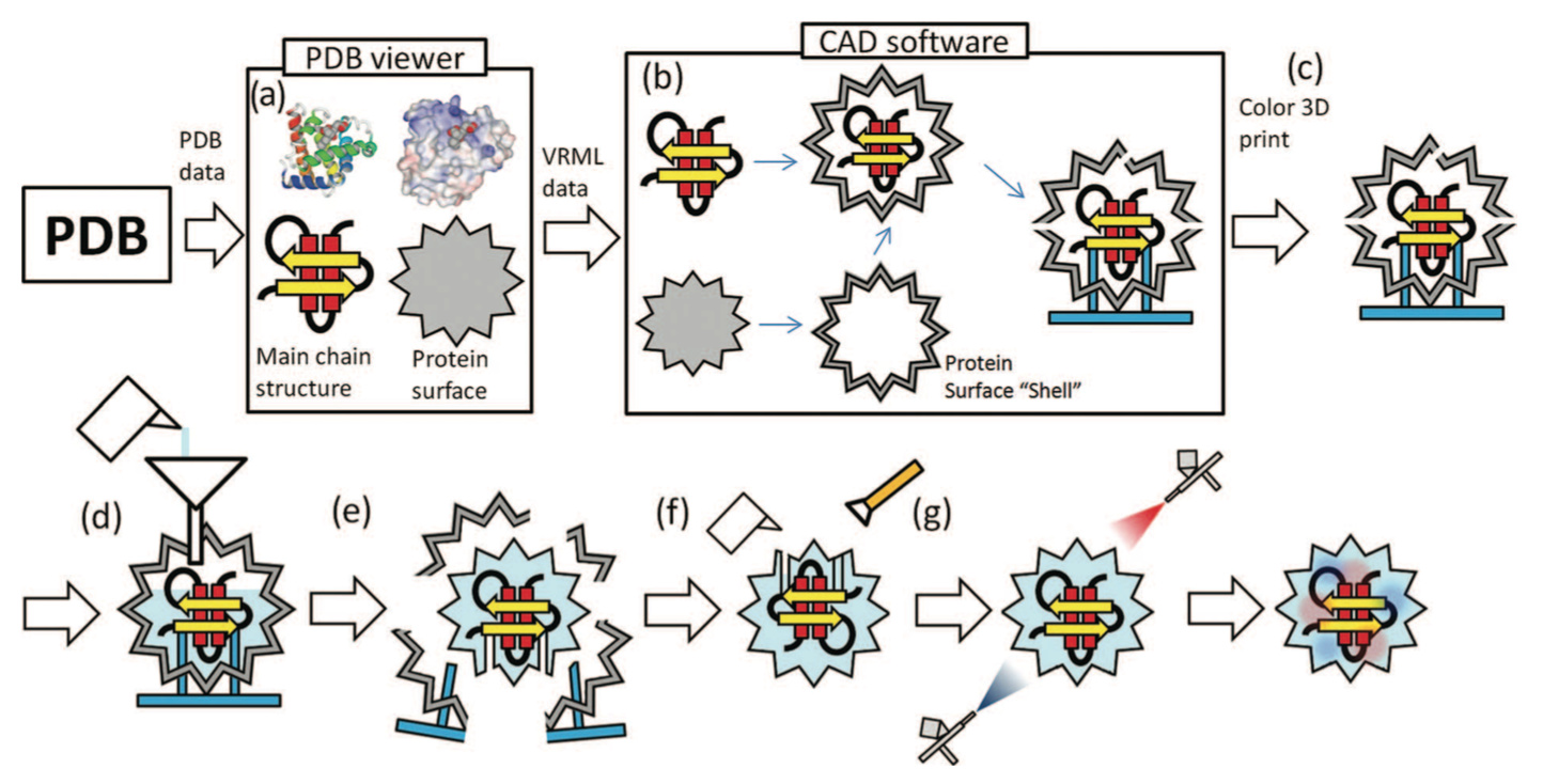

To produce such a model one needs to print a model of the internal ribbon structure and an outside mold. This is then used to pour in liquid silicone to create the exterior surface.
He published a detailed description of the process in 2012: Kawakami12 surface+ribbon.pdf 4.
Is anybody brave enough to attempt to create such a model for glucokinase?
Here are the models for the interior glucokinase ribbon v4.wrl and the exterior surface glucokinase surface v3.wrl , equivalent to this step in the process:
