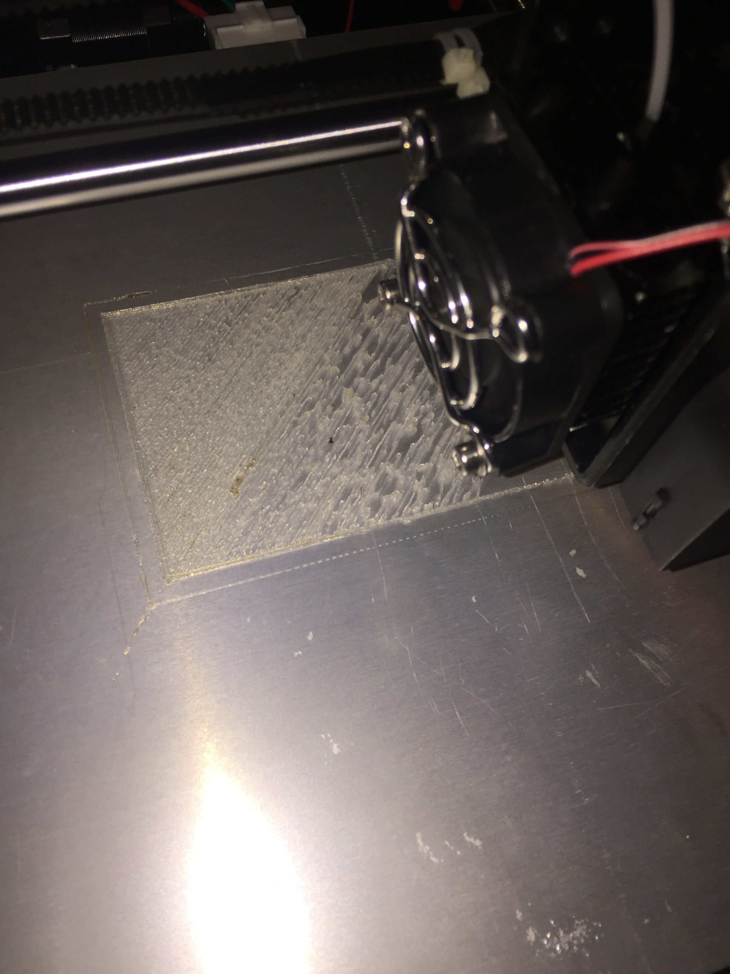

Hi there,
I assembled my Anet A8 and my first print looks a bit odd. Any suggestions what I can do to improve the printing quality?
Thank you ?
So I would check my nozzle temp, 190 c for PLA, and 240 for ABS. It also looks like it either dwelling too long and burning and it should be printing at speed 60 or your feed rate is too low, make sure it’s at 100%. Also check your fan connections and you may need to manually set your fans to turn ilong earlier if your original temperature is correct. Can you send a pic if your extruder, bed and print settings? Are you using Cura? More information is better :slight_smile:
Looks like under extrusion and/or problems sticking to the bed.
Is that a glass bed? You’d be better off with an adhesive build plate.
Your nozzle may be too close to the bed. I would lower the bed a bit and re-level.
The anet a8 comes with a brushed steel plate. So it does indeed have a hard time sticking to it.
That side is too far from bed, level bed again.
I looks strange, is your bed levelt? Can you push filament true with your hand?
it seems that your bed is not level, screw the odd corner upwards a bit and try again :slight_smile:
What is the hairspray for? Does it stick better?

I agree with (some) others - your bed isn’t level, and probably a touch too far from the nozzle.
That first layer should be flat, wide, and squished. Are you using a feeler gauge for leveling?

Hi, yes hairspray is simply very thin, water soluble glue. Works very well on a glass bed.
It seems like you have some under extrusion at the second half. This could have multiple reasons:
Clogged nozzle
Nozzle temperature is too low (unlikely)
Your extrusion motor is overheating (and is shutting down!)
Your extrusion motor doesnt get enough power (unlikely)
Your extrusion gear wheel lost grip on the filament
It could also be that your bed is not flat.
I would check your nozzle for clogs.
