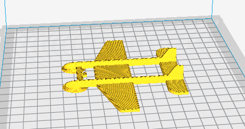

Sorry if this is a duplicate but I couldn’t find anything so I figured I’d post. Redirect me by all means if someone else has posted something related to this problem.
I made my first two prints today on the A8 and they turned out awesome. One was the chess piece pre-loaded on the card, and the second was an upgrade off thingiverse. I noticed on both of them (and on cura for the third print I wanted to start) that there were these totally awkward and unnecessary bases that did nothing but use my filament and my time because I had to pick them off with a knife.
It’s like an extra perimeter’s circumference on my first print about 2 or three layers thick, and you can see it on the two tips of the glider in cura. I have no idea why it’s there, I have printed this glider before on a school printer and it never printed these. I’m using the exact same file, and neither of the three prints require supports. Any Ideas?
Solved: Please delete this post if reviewed
Hi there,
It sounds like you might have “raft” turned on in your slicer, which would cause an extra 3 layers to be printed before the part begins.
Best,
Maddie - 3D Hubs
