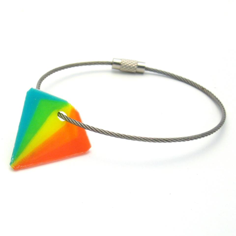

And then there is the layer overlapping technique where you overlap the color in each layer.
This technique also works best with slightly transparent filaments.
We used this technique on our key hanger.

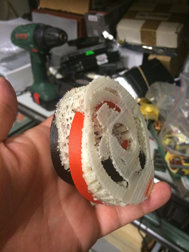

This is the main techniques of 3D color printing with the Diamond Hotend that we have tried so far but there is also the possibilities of mixing different materials as long at they are in the same temperature range.
Our beta tester Michael Holm has printed with red and black PLA using PVA as a support material.
