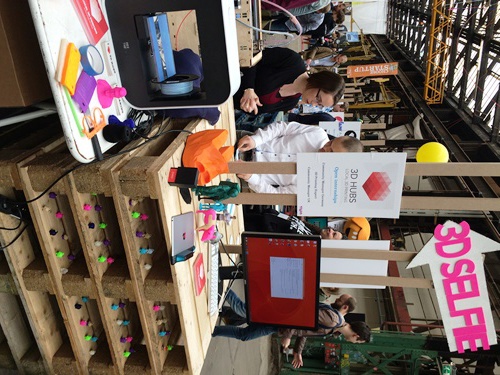

Great story! I just used a Structure with ItSeez3D at 3D Printshow Berlin and got some great results. And yes, people all have that stiff look that early-1900 photographs had too. You have to stay still for 30 seconds, I guess that’s kind of frightening :wink:
Here are our scans:
We also 3D printed most of them during the show:
Hey @bartv , This was an awesome tip. The scans you did look really great! Much better than the ones we did. However, I found it quite difficult to scan with this app. Did you have a special set-up (with good light etc.) Or you just scanned people in an open area?
Yes, good light is essential, and I try to capture people in daylight whenever I can. We were lucky in Berlin as we had a large window in the ceiling right at our location. I’m also experimenting with LED light bars, but they tend to give harsh shadows.
