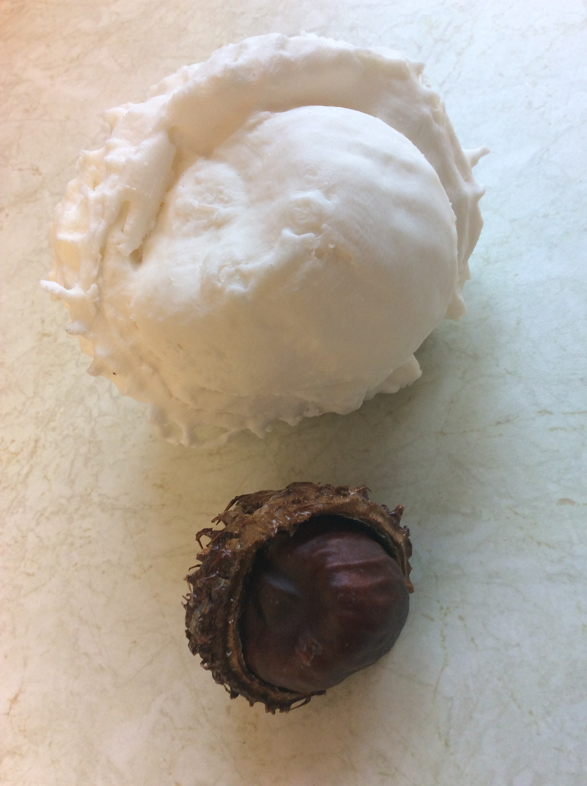

Since we’re specifically talking about scanning for 3D printing, I thought I’d share a technique that I’ve found useful ( if a little time-consuming! ) for smaller objects. For example, I needed to scan a Horse Chestnut ( We call it a “Conker” here in the UK - Google it and you’ll find out why. ) and produce prints at half scale. The conker was only about 5cm at its largest dimension, so it was going to be a challenge to preserve as much detail as I needed. So, I scanned the nut several times -and from various orientations - and integrated all of the point clouds together ( This is always advised for laser scanning ). Then I printed out the resulting mesh at double size in white ABS. I finished and trimmed the large print so that it was exactly as I wanted its miniature counterparts to be, then scanned that, plenty of times. The sanded white plastic was a perfect surface for scanning. This gave me a really rich mesh that I could scale down to half of the original scale. It may sound like a rather laborious method but I assure you, it’s worth it, if you want to get good results and don’t want to spend a fortune!

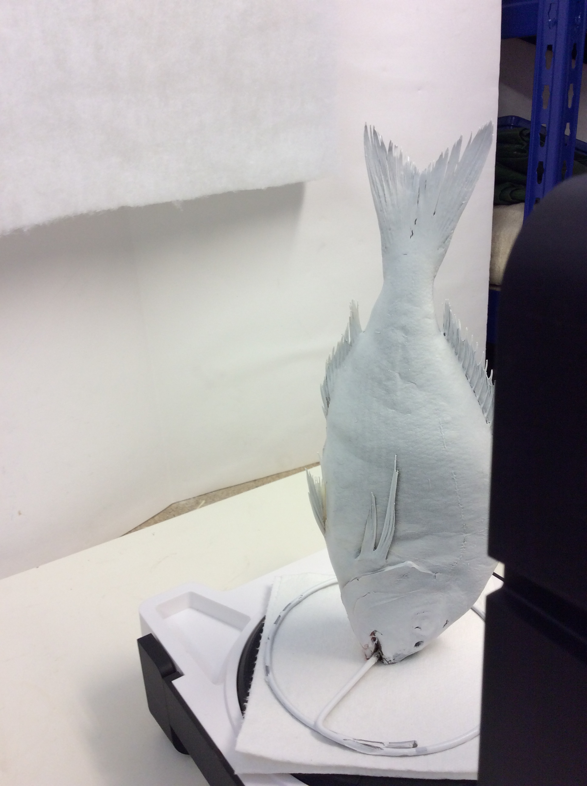

Talcum powder is sometimes useful to reduce reflection. I also use rattle cans of white rubberised paint, which can be peeled off high-gloss hard surfaces after I’ve scanned them. I even used it on a dead fish I scanned for one job! OMG! I’ll never forget the smell of rubber, and 4 day-old fish! Gak!! :-/

Thanks @derKarsten. Yeah. Think there would be a “Nose offence premium” for future fishy jobs but other than the scanning it was a really fun project. More info on that project here…
