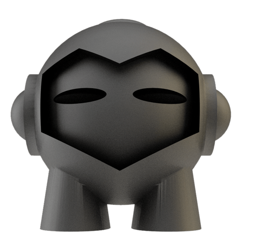

Lighting
This is one of the most important things to consider when setting up your scan.
For the photogrammetry you will want a well lighted object, just as you would need it for normal photos. Shadows make it difficult to track the object and might result in excessive noise.
Pro-tip: A very good condition for 3D scanning is actually outside, on a cloudy day, because it evens out the lightning just as a good studio. Prefer natural light over artificial lightning.
Lightning is much less of a problem for the laser scanners, as the technology is not based on visual light. However, direct sunlight might cause a lot of “noise” for the software to interpret, thus the same best conditions can apply here. Since the scanning is based on emitting light - they can even be used at night.
You can see how the direct light affects the object in this awesome model :slight_smile:

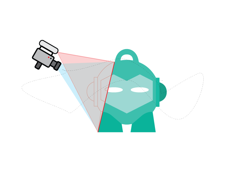

The Scanning Method
As you need to scan an object from all sides and angles, there’s basically 2 things you can do; you can either spin the object and take pictures from one standpoint, or walk around the object itself and take pictures from all sides.
When walking around with a camera - you need to make sure to take pictures of the whole object (for it not to have any unknown “gaps”). Be careful not to cast shadows on it as well. Try to keep a constant distance between your camera and the object to scan. Another tip, discard all blurry photos, the post processing software won’t be able to correctly stitch them.
If you have a portable laser scanner, the best method is to apply a wave motion - going up and down with the scanner, to capture the whole body, especially the top and the complicated places like under the chin (when scanning a person). Applying the wave motion gives you a good spectrum of reflection which gives you a better image result. Move slowly.
