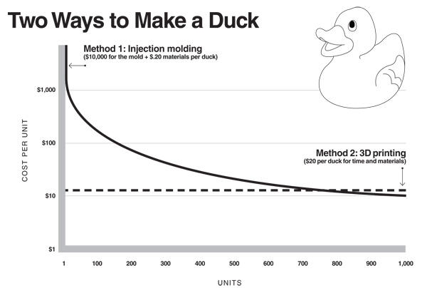

I have a smart toy product with about 13 different parts. I am doing a cost comparison of doing a plastic mold for all 13 parts vs doing 3d printing for all of them.
I dont see any options related to 3D printing for volume production where you could assemble say 5000 products with just 3d printing. Is volume manufacturing practical with 3d printing.

Hi @omniengr the answer to your question is almost always going to be “no”. In most cases, 3D printing is best suited to prototyping, unique creations or short runs of final product. Once you start looking at production runs in the hundreds, and certainly when you’re talking about thousands, other methods of production become much more cost efficient.

Hello @omniengr!
That is a good question. I can tell you right off the bat that 5000 units is not practical to produce using 3D printing. I have attached a popular graph (source: 3dprinting.com 303) that customers like to look at when asking this question. The difference here is that the calculation assumes you have both an injection moulding machine and a 3D printer already at hand and you are comparing both processes. Injection moulding requires a mould which you amortise by producing large amounts. Hence price per unit goes down. 3D printing is tool-less so the price per unit is always the same.
The intersection of the two graphs is the magic number where 3D printing would make sense if it is under that volume. In this example, 750 ducks is the intersection point. Which means if I were to produce 600 ducks it would be cheaper to 3D print, of course, a longer production time is usually the problem here. There is, of course, the option to outsource the printing to different hubs but it will be costly for large amounts.
If your smart toy product consists of 13 parts which are very complex in geometry and requires a very complex mould then maybe, just maybe 3D printing would make sense. If after evaluating your situation and you decide to go with 3D printing, I might recommend this printer http://stacker3d.com 156 . I used the word might as I have not worked with this printer before and do not know the consistency and quality of the prints.
Perhaps it makes sense to print one or two of the 13 components because it is cheaper that way. It really depends on how you designed it. Maybe you can combine 3 components together and save on the mould cost that way. There is no straight forward answer and one has to think out of the box.

Thanks James and others for quick response. I have reduced the parts to the minimum to save on mold costs. So, it looks injection molding is only way to go.
Bite the bullet and get the molds made up - tt will be more cost effective (larger profit) to injection mold unless you purchase and run your own 3D Printers and even then the surface quality of the 3D Printed parts will not meet consumer expectations unless the 3D Printed parts are post processed which will greatly add to the cost.
I agree with @cobnut. There are many factors to consider but for the most part, hundreds MAY be practical and thousands would almost never be practical. 3d printing is best for prototypes (before investing in the tooling for mass production) or custom parts. Obviously, there are exceptions to everything.
