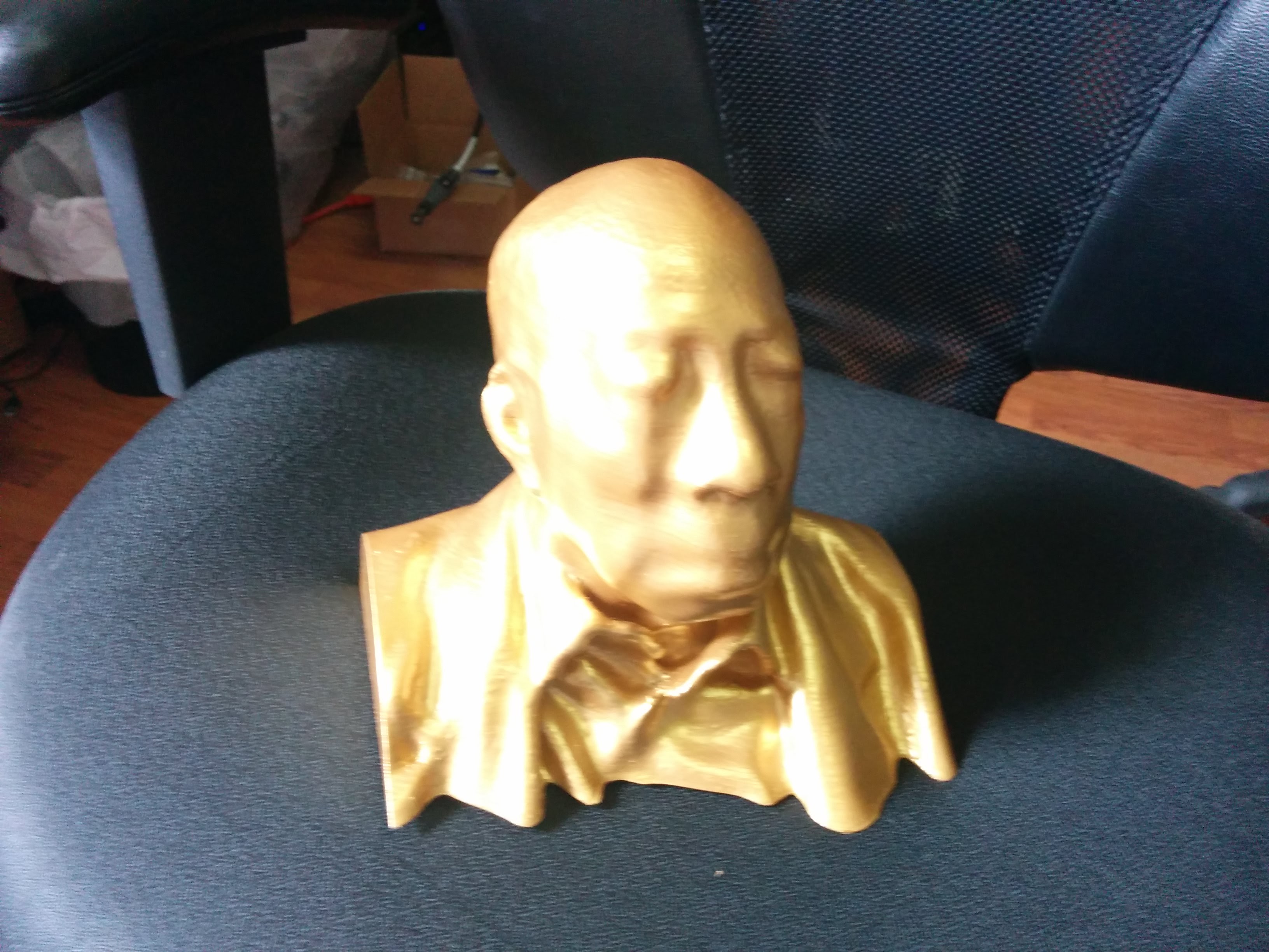

There are bronze and metallic filament for FDM printers (if you ever chose FDM and not HD in which case the price could be that high), but if you want to save on cost, like @Ohlyver said the cheapest way is certainly to print it in PLA or ABS to permit the jewelry to be extensible, then to paint it. Still there is a question of final result quality and look. I attach here an example of gold finishing that we delivered, but the object is not that tiny that the dimensions communicated by you. If you have a file or at least the picture of how it should look, i am sure we all could give a better advice. Thank you in advance.
