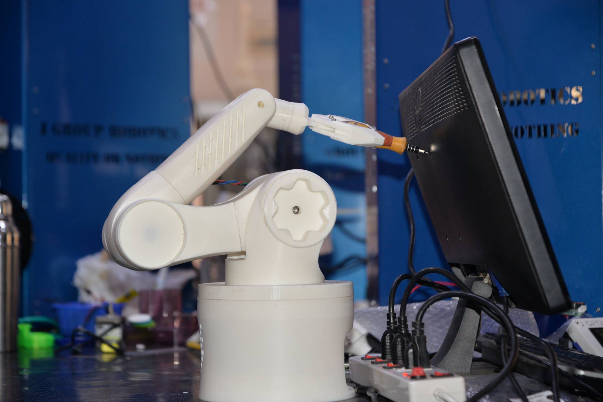

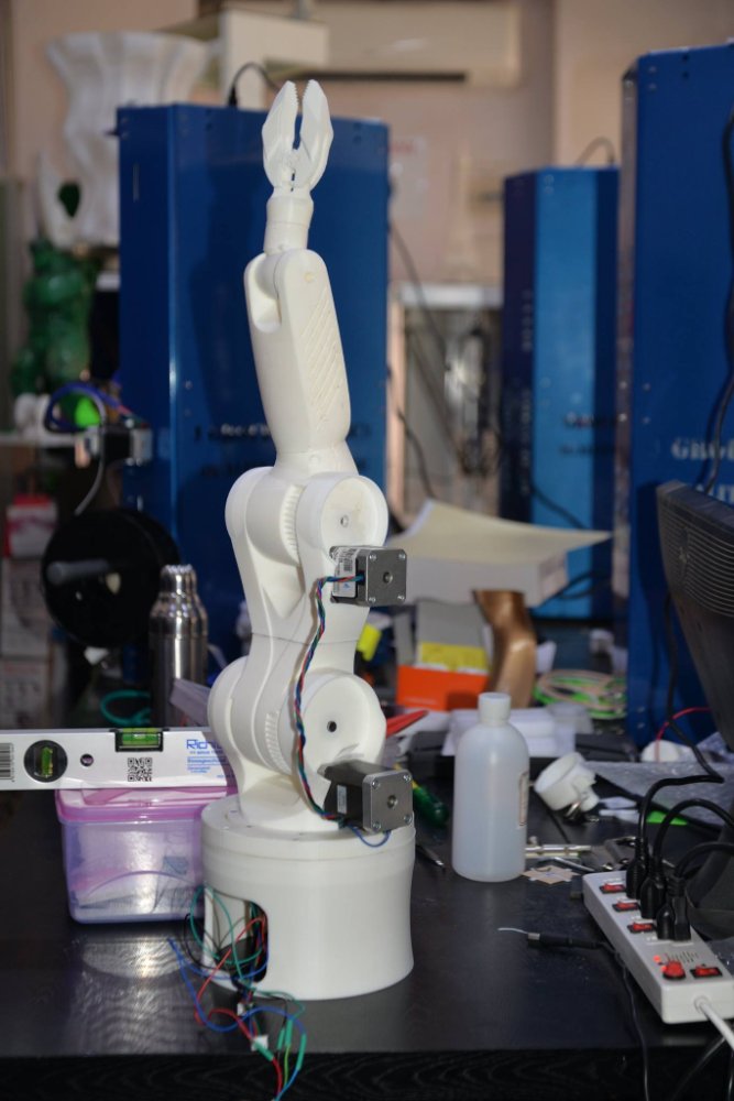

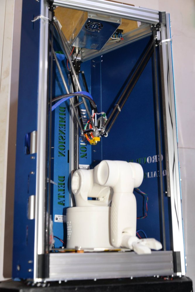

J Group Robotics 2 3D printed a robot Inspired by kuka robots. This robot has 6 axis of freedom out of which 3 are motorized using stepper motor and controlled using Ramps. This robot moves on Gcode. firmware marlin. This was printed @200 microns with Dimension Delta 3D printer .
