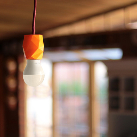

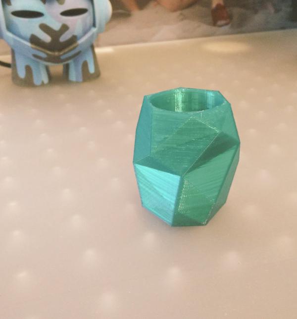

We have so many 3D files lined up for printing that and today was the time for our Leapfrog to get to work and print this great lump model from Cults
And this is exactly what we did (The Marvin is jealous that I am not taking picture of him - you can see that in his eyes):
  • 0.2mm layer height
  • 20% infill
  • material PLA
  • no heated bed
  • nozzle temperature 210
  • -50% cooling
  • Support: The model is hollow , but the support is not necessary anywhere here.
Any other cool office “pimping” projects you could suggest? There must be something huge (knowing the huge build platform) that we could print.

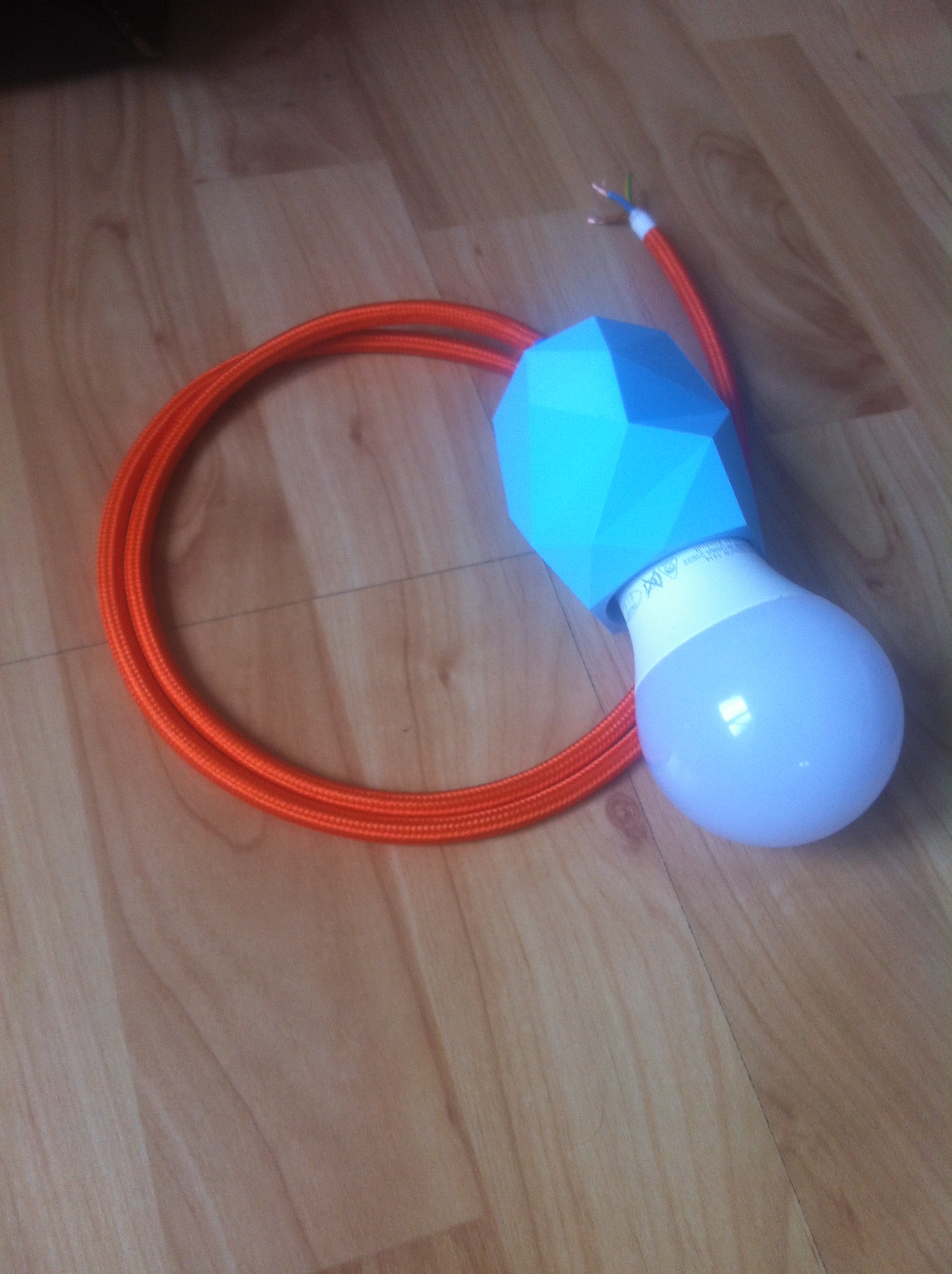

It’s going on the printer this afternoon. Black print, white cord. I’ll keep you posted!

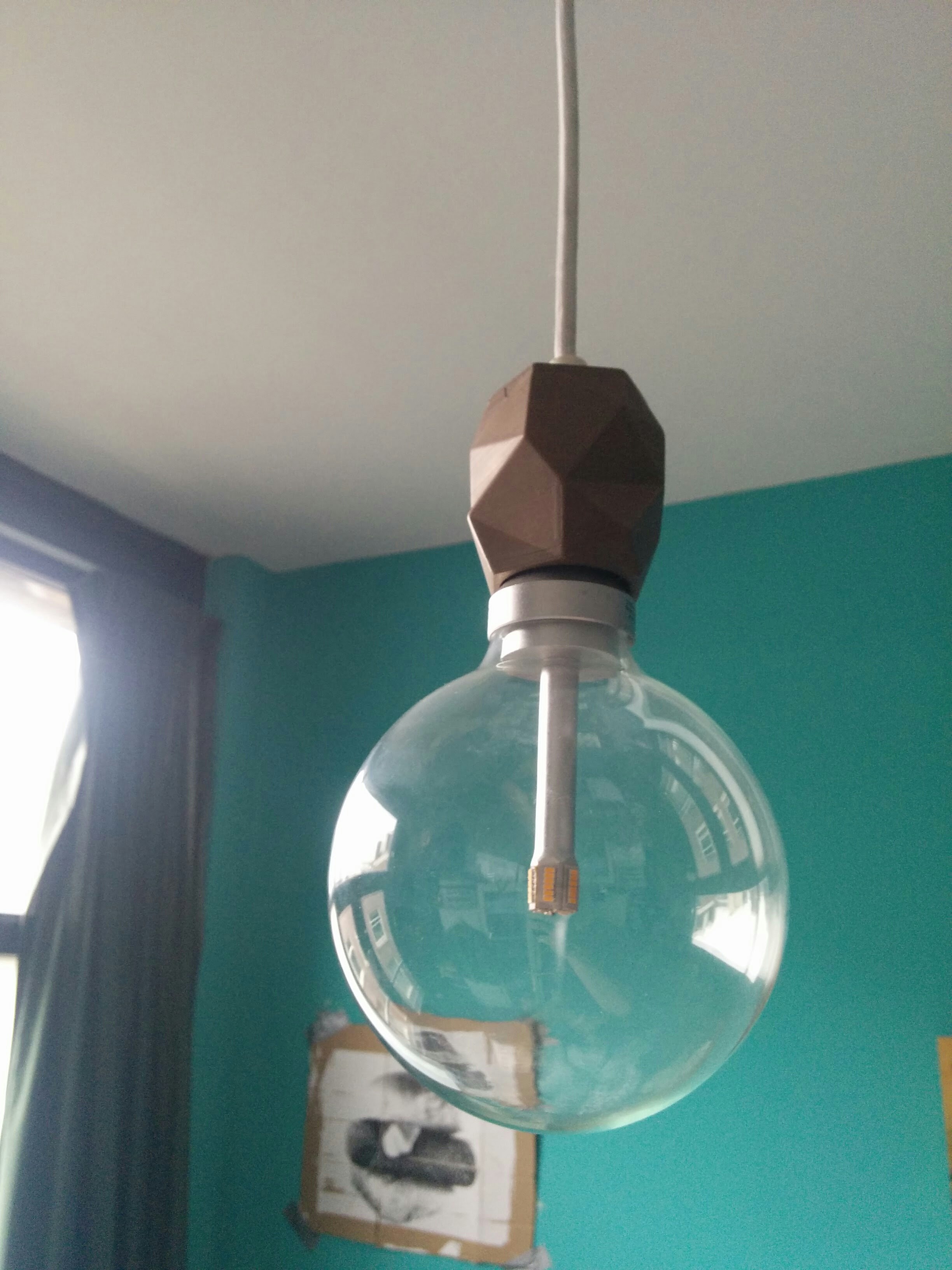

Made it from bronzefill with a larger bulb, looks great.
That is super cool @Remy_S! Did you have to modify the design at all?
The bulb uses the same E27 socket as the smaller bulb. I had to sand down the inside of the print a bit because the fit was a bit too tight. Which was more a problem with the filament, the model is great!
