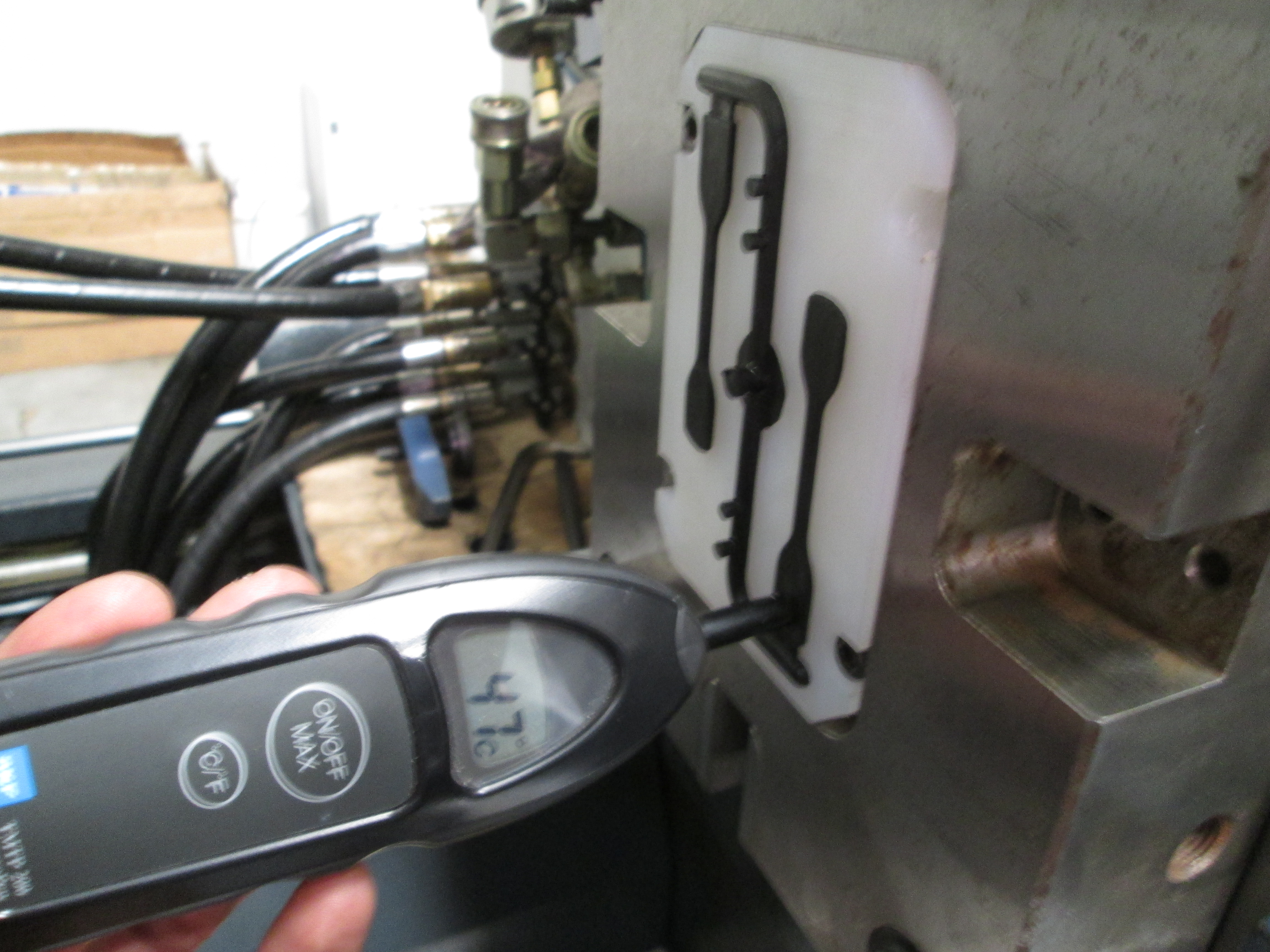

Hello. I did my Master Degree in product development about the use of injection molds made with polymeric materials. The big conclusion is that we must control the mold temperature and avoid to cross the Tg (Transion temperature of the mold base material). Example if your mold is made of ABS_Like for Stratasys Polyjet and the Tg is around 50º you must cool down (freeze) the mold in the next injection cycle. Note: Control every cycle the mold temperature otherwise the mold will be damage.
Thanks for your feedback. As the mold resin is in direct contact with the hot nozzle, the plastic enters very hot and the gap in the mold appears only in the first few centimeters but the cavities are still very crisp in detail after a couple of shots I assume that an aluminum shell could help spread/take the heat. This would make 3d printed molds out of normal resin possible. If you would have a couple of these 3d printed cavities/aluminum shell molds to stress relieve your molds you would be able to get a lot good shoot out of inexpensive and fast to produce molds

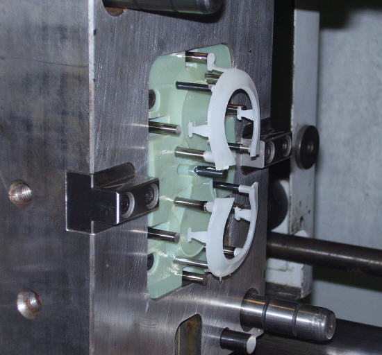

Hello again. I use 3 kinds of material in the mold cavities. The mold base is steel and the cavities are assembly in the mold base. To have a long tool life we need to control the temperature of the PA6 cavities and cool each shot. To cool the cavity I use air pressure flow (30 to 60 seconds).
In this image I have a ABS_Like cavity after 50 shots
The gate is steel material because is the part with more temperature time.

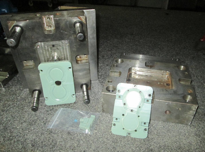

I´m in Marinha Grande - Portugal and in this region we have 200 Moldmaking companies so is easy to buy such mold base or buying in standard suppliers (Hasco, DME, Meusburger, etc…). But the sites presented looks very good (but are for US market). About material we handle bags 25 kg (PP, ABS, PC, HDPE etc…)
Mold example
