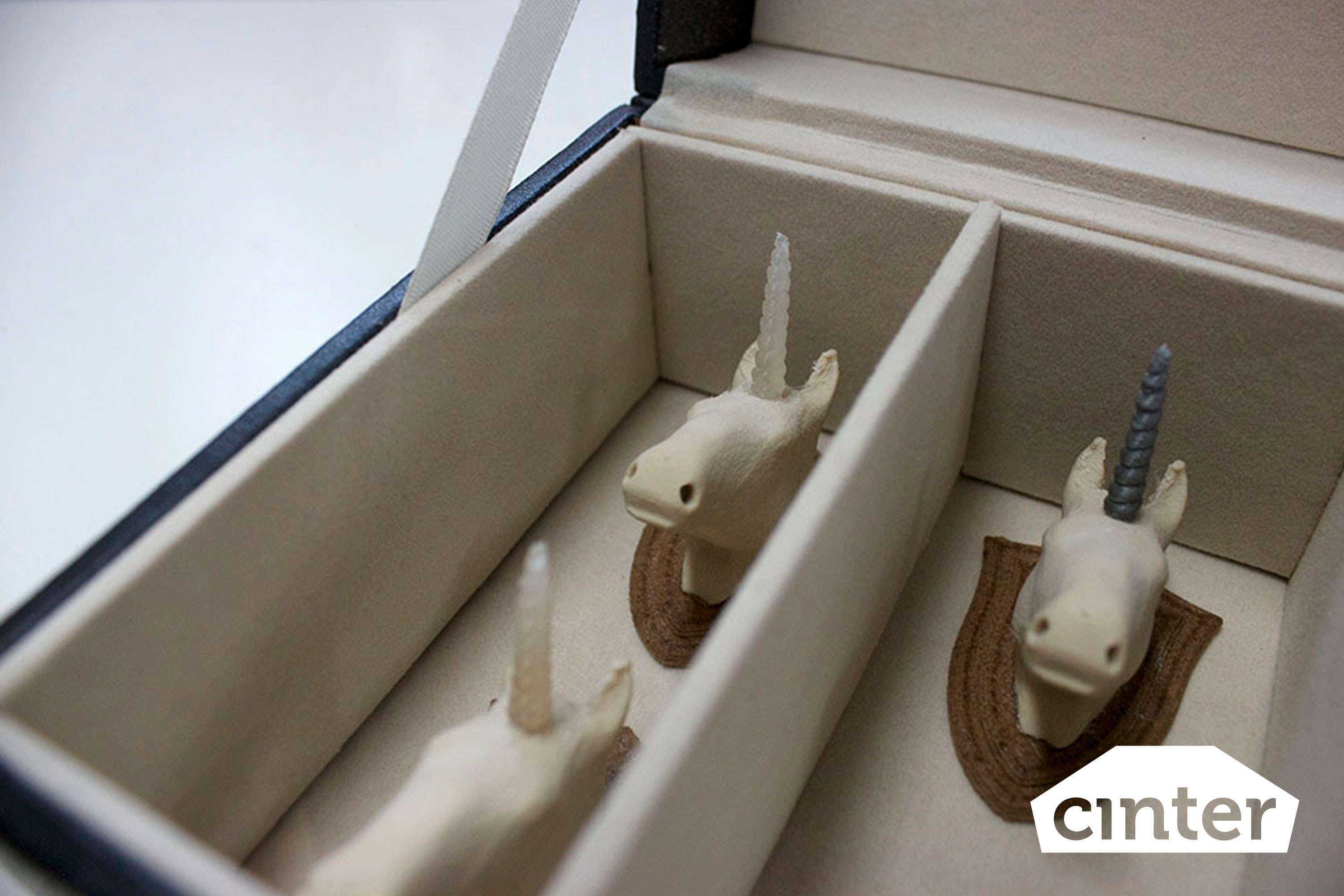

We are often asked how we created the animal head designs (see unicorn photo which is one of our first prints). Our process takes two outlines, gathered from front and side view photos, cross-extruded in Rhino software and later taken into mesh mixer to do the final contouring.

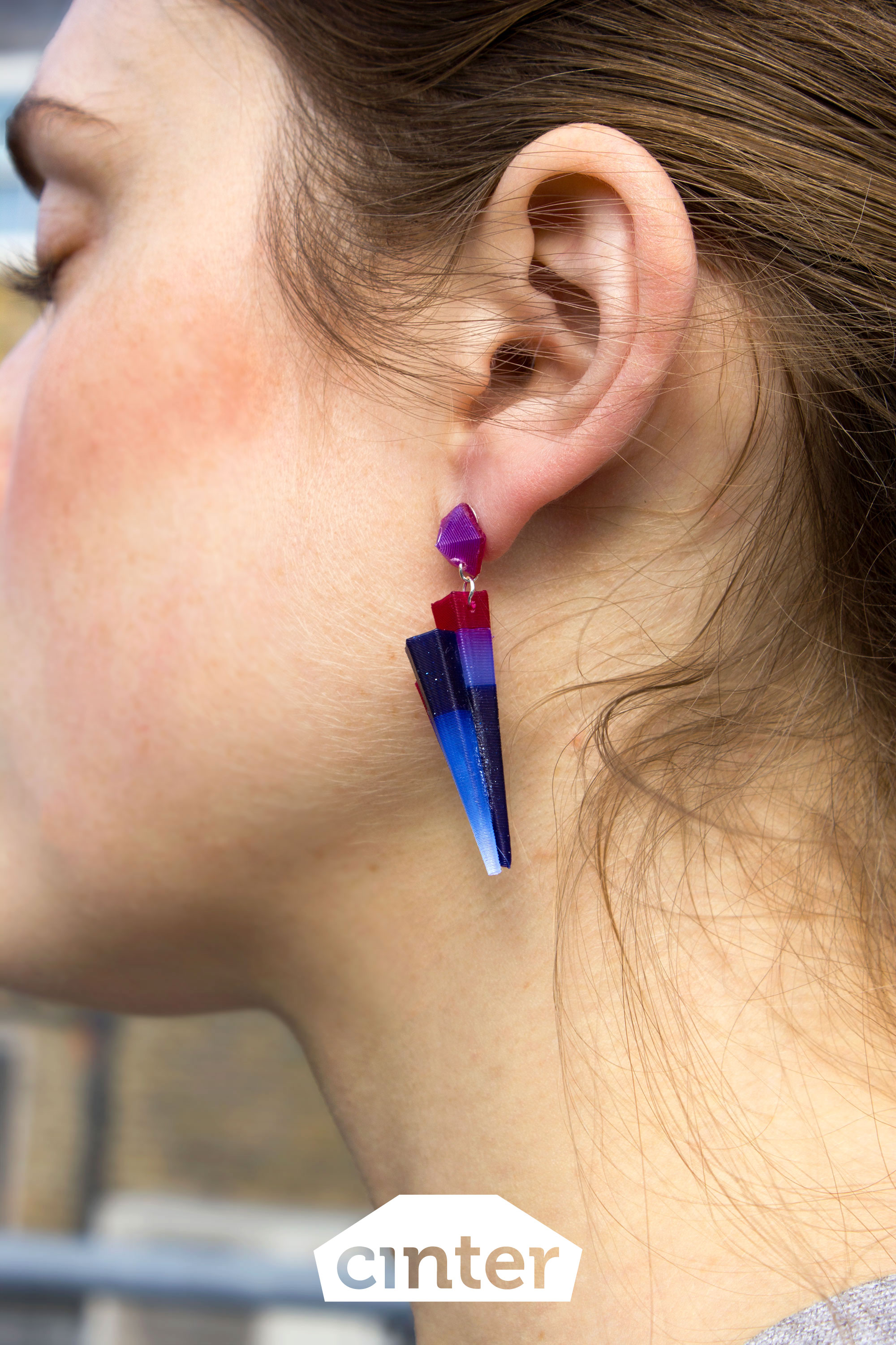

Thanks guys! So to answer Filemon’s question, using the pause setting on the Makerbot during a build offers a wide range of added functionality. Not only can you pause it if you want to leave it unattended or to just check the progress of your build but you can also change the filament. The coloured jewellery is a great example of this, it is how we have achieved different layers/gradients of colour in the build.
