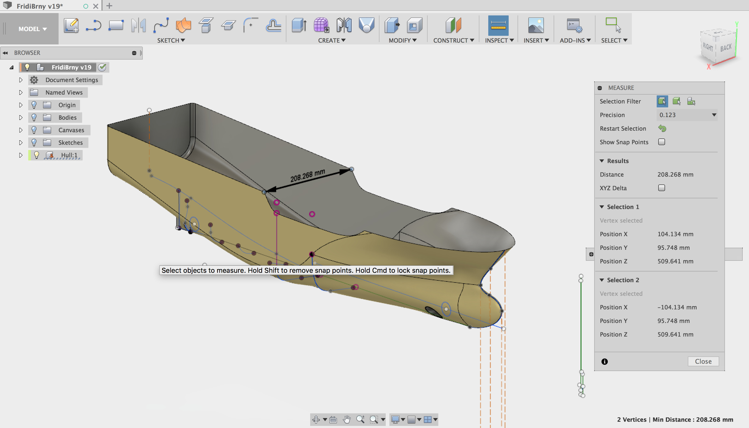

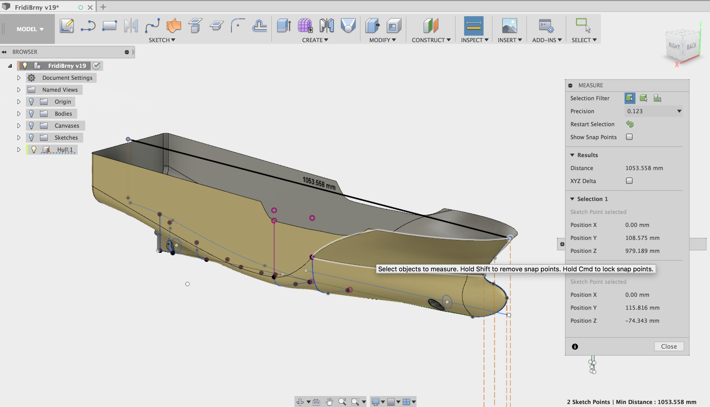

I have two model boats I’d like to print one at 1.05m in length and the other at 70cm. I’m completely new to 3d printing and would like some help to print this model in sections and join it all together.
I’m looking for a good quality method but at a resonable cost. I have no knowledge of 3d printing so any information and guidance would be appreciated.

thanks for the reply, yeah I’m the designer myself. I have one of the two designs finalised, just adding the finishing touches to the larger of the two models… I’m located in Spain, but distance is not an issue it’s more the right price. I’ve downloaded the 3d printing handbook to help me also!! Very interesting book!!!

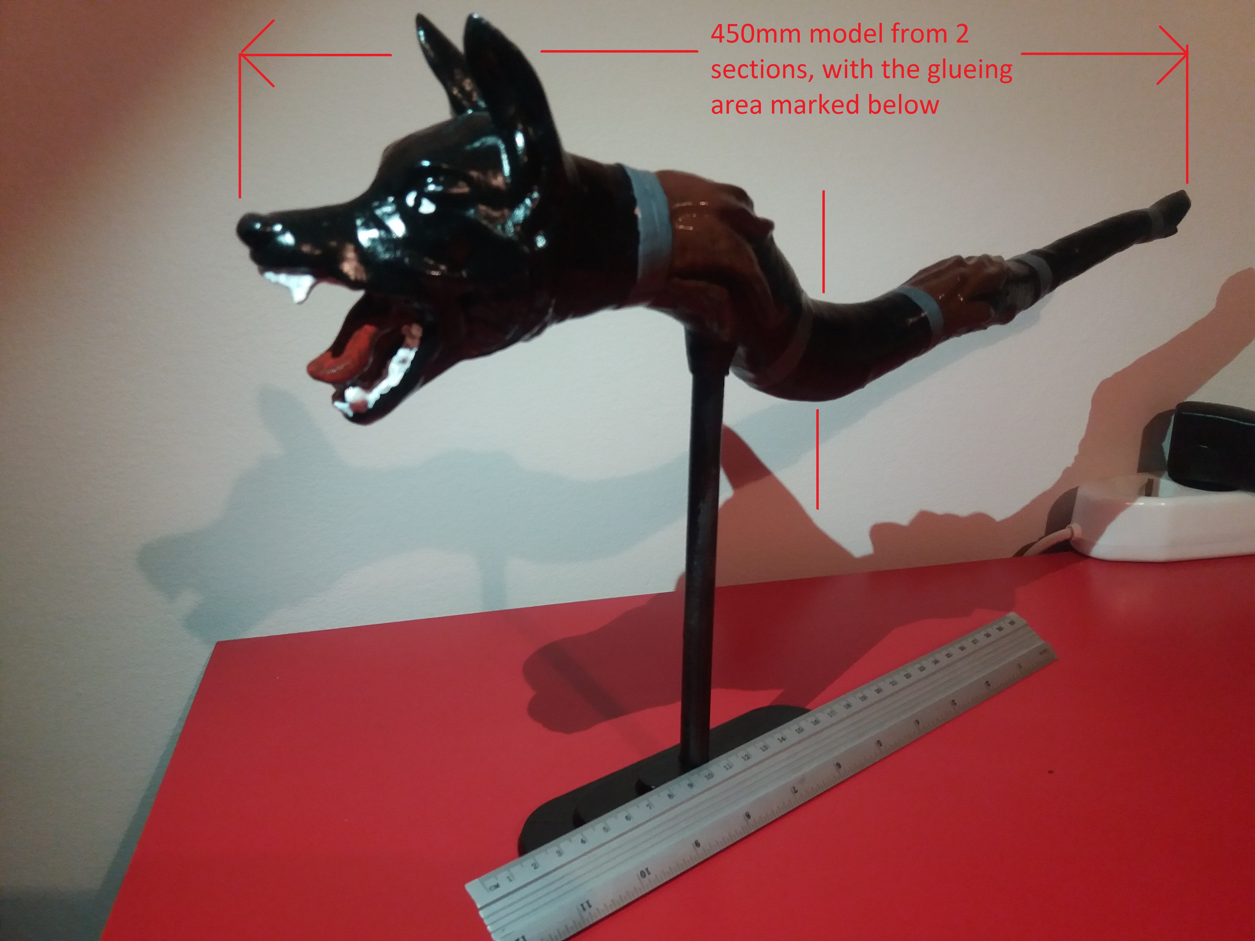

I am printing just now a 1 meter model in multiple sections (actually, by “now” I mean a few days as it is a long process).
If you want, I can print those 2 models for you.
I inform you that I would like to do the sections myself from the full 3D model, because I have the some experience with this and also with my printer and it’s capabilities.
But we can further discuss your needs.
In order to have a good finished assembled part, I design special holes in the part, or one big hole that I will fill with some rigid rods (metal or plastic). This helps in 2 ways: it helps the assembly to be accurate (as little mismatch as possible between the sections) and also offers better rigidity for the assembled parts and ensure that the gluing will remain strong.
I also like to do the assembly myself and ship the full part. I have experience with technics that help mask the assembly line between the sections so that it will not be visible.
I am located in Romania and can ship to Spain with no issue, but I will add the transport cost to the total cost of the print (this is done automatically by 3D hubs by a default price, but the actual price can be higher or lower depending on the package and the shipment).

I have never printed ship models, but I see no particular issue in doing this. For 3D printing, especially for FDM type, it is not important what model you are printing (a cube, a boat, a dragon, a dog, an automotive prototype functional part, etc), what is important is that the design of the part to be made in such a way that it would be printable on a 3D printer (my main concern would be thin walls).
As for buying your own 3D printer, I am encourageing everyone to do this. It is a fun hobby (sometimes annoying). The Prusa i3 Mk3 looks like one of the best FDM 3D printer on the market (except for the high end industrial and professional 3D printers that start at 25.000 euro and can go up to 200.000 euro). I actually intend to purchase one in the near future (the Prusa i3 Mk3, not the big expensive printers).
Please see the first picture of one of my finished products (450mm long, see the 300mm ruler in the picture for dimensional reference). The part on top is done from 2 components glued togher. The assembly line is hidden (I present it in the second picture) and the part is finished and painted.
As I said I am working now on a 1000mm model, it is actually the exact same model, scalled up. Please see the 3rd picture with some of the sections printed and in comparison to the original 450mm model. I should be able to have the final part (assembled, finished and painted) in this weekend and I will post another picture if you are interested.

Can you send me your email address, I’ve a few screen shots with dimensions of my model for you to have a look at for some advice on printing my model, my email is m5currie@hotmail.com
get in touch and we can start discussing some techniques for my design to be printed.
