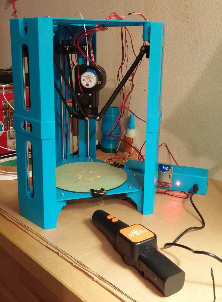

I got an email today with the tracking number for the shipment of my printer. An hour later UPS was here with the printer. <sarcasm_mode>Now that’s quick service.</sarcasm_mode>
It took about half an hour to put together. Here’s a picture of it:
It has some issues. I didn’t expect perfect for $79 (I bought the developer version). So, let’s get to it…

Loading filament is a pain. Undo two screws, open the front door of the extruder, push the filament in, then close the door and screw it shut. No controls, no screen so the filament will not come out for a while when you tell it to print. Print something smallish to get the filament through to the nozzle.
And the extruder motor is mounted above the extruder and nozzle. With the connector rods at the bottom of the unit, there is some shaking as the head moves.
One button. Load the file onto the SD card, put it in the controller and push the one button. After a minute or so, the extruder will get up to heat and the extruder starts moving. Up to the top to hit the limit switches then down to print. Not fast, but it doesn’t have to be.
Movement is jerky. I’m planning to lubricate the rods although the instructions say it’s not necessary. I’ve got one vertical that binds and doesn’t move to the top without my help. One that left a bearing behind as it moved and one that seems okay. I’ll play with it to see what I can do.

Update on the 101Hero.
The upright that was binding will now only go up about two thirds of the way and then stop. It won’t move even if I add some force with my hand. The stepper motor just buzzes. I will continue to work on finding out why it’s binding at that spot.
I did get a start on a Marvin. Got the legs and first couple of layers of the body before it broke loose from the build plate. Every layer was shifted because of the one upright binding and not moving smoothly. It was interesting, so I thought I’d let it finish. Until it broke loose.
At this point, I can make better prints with the pen.
I didn’t expect much for $79 and I got what I expected (not much).

I have not heard anything back from them when I asked about a replacement stepper. I’ve taken a good look at it and checked out the stepper online - it uses nylon gears and they appear to be stripped. When the upright bound, it seems to have stripped the gears.
I can’t seem to source the stepper online either. I can get one with the same part number and voltage, but they are all 1/64 steppers and not 1/32 like the ones in the 101Hero. I have yet to find a way to access the firmware settings. If I can, I will see if I can change the steps setting.
