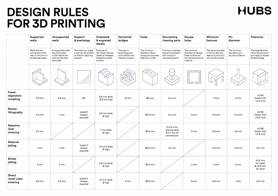

3D printing design guidelines
Design guidelines applicable for all 3D printing processes
Design guidelines for specific processes
Design guidelines for specific parts

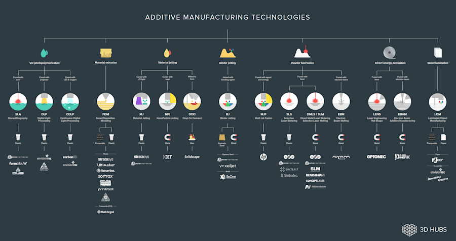

The whole landscape of additive manufacturing technologies can be summarized in a simple tree-diagram:
03 Design rules for 3D printing poster crop
Click here to download a high-resolution version of this poster.
Our article on The Seven Official Types Of 3D Printers gives a broad overview of how each type of printer works, the materials available, the price and speed of printing, geometric properties (size, complexity & resolution), mechanical properties (accuracy, strength & surface finish) and common applications.
Looking for more in-depth information on the topic? We also wrote a handbook on 3D printing. If you’re a professional looking to truly master the key aspects of 3D printing, this book is for you.
The exact best practices and rules of thumb vary between the different 3D printing technologies, but there are certain features you always need to pay attention to:
  • Supported wall thickness
  • Unsupported wall thickness
  • Supports and overhangs
  • Embossed and engraved details
  • Horizontal bridges
  • Holes
  • Connecting or moving parts
  • Escape holes
  • Minimum feature size
  • Minimum pin diameter
  • Maximum tolerance
The process-specific design rules for each of these features are summarized in the graphic below:
002-003-3DP-Rules-Poster Hubs DEF Thumbnail
