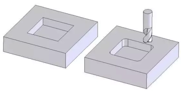

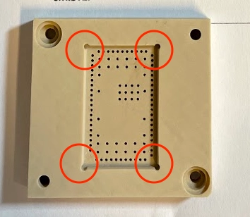

Sharp corners
Internal sharp corners require EDM machining and increase significantly machining costs, therefore they should be avoided as much as possible. Most of the time, when sharp corners are requested, the supplier will suggest changes that will make the part easier to machine.
Here is the order of options considered when sharp corners are present on the CAD model:
Increasing the radii
A radius of at least 1/4 of the pocket depth can be suggested
For example, this pocket is 10mm deep, at least 2.5mm radius will be suggested.
"Dog bones" fillet can be suggested
EDM (sinking EDM or wire-EDM): EDM should only be reserved for the cases where the sharp corners are absolutely indispensable. It will significantly increase machining costs.
