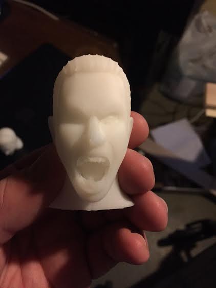

Usually with warping it’s on the bottom of a part.
Your issue may be warping but again I have never seen a part split like that.
As others have suggested, level your table, manually if you have to.
Put cardboard around sides of your machine and in the front to try to retain heat.
Try Z-Ultrat or even Z-HIPS, I use Z-HIPS all the time to print my models as it print a lot nicer then Z-ABS or Z-ULTRA and it has other benefits as well.

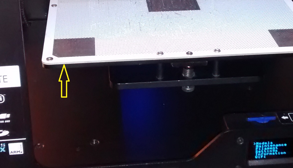

Hi, don’t know if this will help with the cracks in your prints but I agree with all the posts that leveling the bed and heat is a major problem sometimes. Just that when you mentioned not being able to level the bed reminded me of something I had to do once I had that same problem.
Not sure if anyone has taken apart the heating platform/perforated sheet combo. I was curious one day to see how they came apart and took all the hex screws out that attach the perf board to the heated platform. What I found should have been more obvious. Filament balls!!
Lots and lots of balls the size of the perforations. Every time you scrape a print off the board some of the plastic stays in the the holes. As the printer prints over them some of them get pushed between the board and the heated bed. After I cleaned off both the heated bed and the other side of the perf board the calibration worked like new!

That’s an odd issue. I have printed many items of similar size and shape in Z-ABS without problems. What was the support angle you selected? Due to the chin overhang it definitely needs some support while printing. I suggest 20-45 degrees.
You might also try a simple test by cutting some cardboard to fit the sides and tape it in place with masking tape. You can still see the print progress from the open top. This may help stabilize the temperature and prevent cracks. I also might try printing it in Z-HIPS or Z-ULTRAT.
Sometime i have the same problem but on layer level. An always on Z-ABS. Will be much better than u will try use Z-Ultrat.
o also u can send me the stl file and i can check it on my printer.
