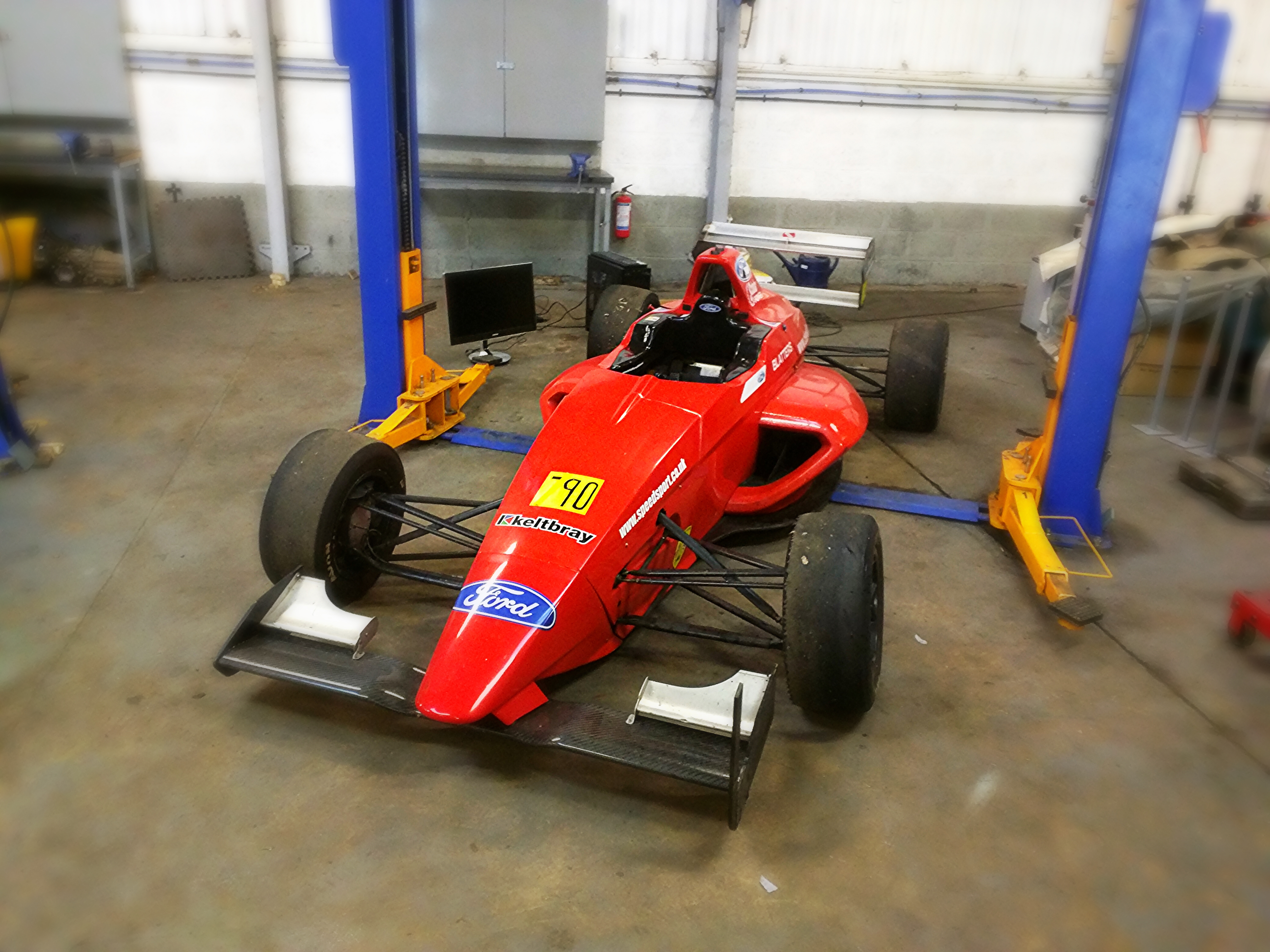

Just thought I would throw this out there for any DIY’ers. I just hooked up the Xbox One Kinect to the PC and got the Microsoft 3D scan app, and it worked fantastic! I just did a few test shots to see how the depth worked out from one side and so far it’s pretty decent. I picked up the Kinect sensor used for $125CAD and the adapter for $65CAD. The software is free from the Microsoft Store, so this is a really cheap 3D scan option. The app exports the completed file in either .STL or.OBJ. Alternatively, you can download the Kinect SDK pack from Microsoft and build the .STL from raw footage.

I was already wondering how I can make this a little more portable. Right now it’s fairly bulky to carry around an object, but it works pretty decent if I keep it stationary.
I have noticed that I need a lot of “flood” type lighting to get a nice quality image and scan. The infrared part of the sensor picks up the object pretty well in low light, but does some weird things with the negative angles that have shadows or are lower lit areas.
