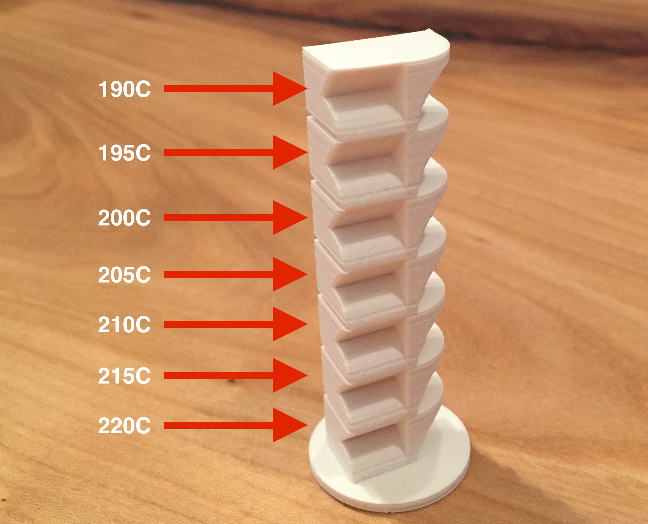

I’m looking for a STL or gcode file to calibrate the print temperature of my UM2.
Something like this (http://www.thingiverse.com/thing:656001 101) looks promising, but it is not complex enough. I would like to see a bit of curves, overhangs etc. per temperature. Does anyone have a good file for that?

Thanks. I know this one, but it would take to much time to print different temperatures.
I’m looking for an object that I can print quickly and that uses the M104 command to change temperatures during one session. I probably have to design one myself :slight_smile:

Cut a piece of their thin test to save time. If you put a different pile heights and the test at different temperatures, the test will not be objective because different angles will have a different temperature and the result can be confusing.
