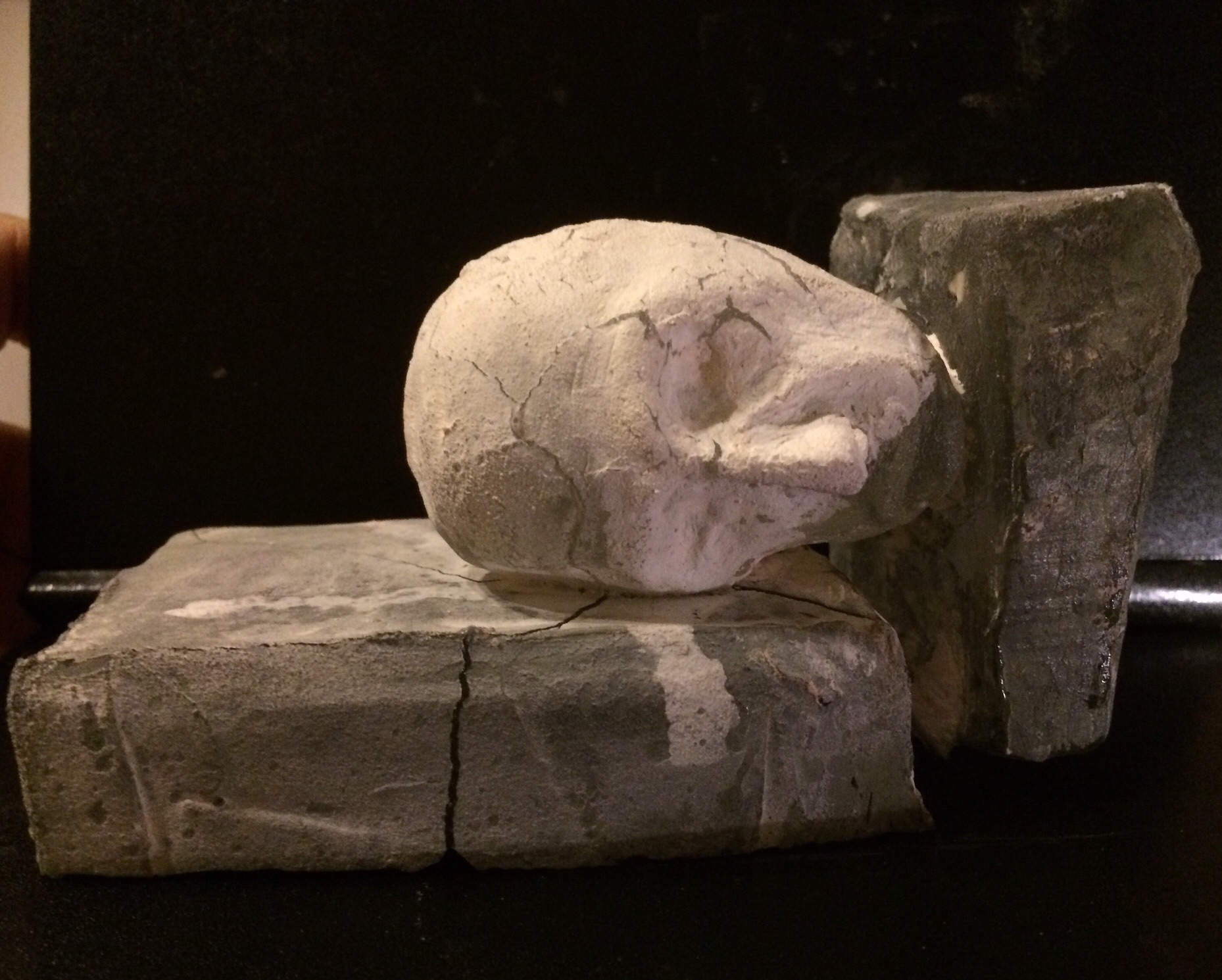

I exploring options to scale up a small glass sculpture (13x8x8 cm).
I envisage it would be possible to scan it and reproduce it doubled in size in another material. ( I would use the new model as a master for hand making making a mould for a lost-wax process). In a perfect world the 3d model would be made wax, which would reduce the number of steps to a new glass casting but Iâve only seen jewellery-sized 3d was printers.

The wax needs to melt much lower for glass casting as the wax gets steamed out. One alternative that just occurred is to print the mould, the inverse. That would need to be in something very flexible and capable of withstanding hot wax
Is it possible to print the mould which is the inverse of the piece? A flexible and temperature resistant rubber into which I would pour hot wax? Attached is the glass piece
Yes, You would need to scan the glass piece to produce a 3d STL file, print it with moldlay filament, then encase in suitable material (concrete) place inside a baking oven at 270 degrees c, which will cause the moldlay to melt out and leave a negative of the glass piece inside; In to which you pour you final material.
Using steam to heat something up to remove it, Is using a very âwetâ kind of heat;
You will get a better result with âdryâ heat which at 270 c from a oven or even a hot air gun will melt most things pretty well to a liquid state.
Here is a you tube video showing the process with moldlay.wax filament lost wax casting with MOLDLAY 3d Filament - YouTube
Probably I need to get hold of some moldlay and try that technique as a technical test. Kiln firing glass using lost wax may appear similar to metal techniques, appear! it is not concrete that is used but a Quartz/plaster/clay investment mix. Glass goes in cold and melts in the kiln, it can be in there for days in a multi-stage heating & cooling cycle. Peeking into the kiln opportunities are limited. Cracks are not good and risk kiln damage. Unmelted wax will cause noxious fumes in a kiln etc.
