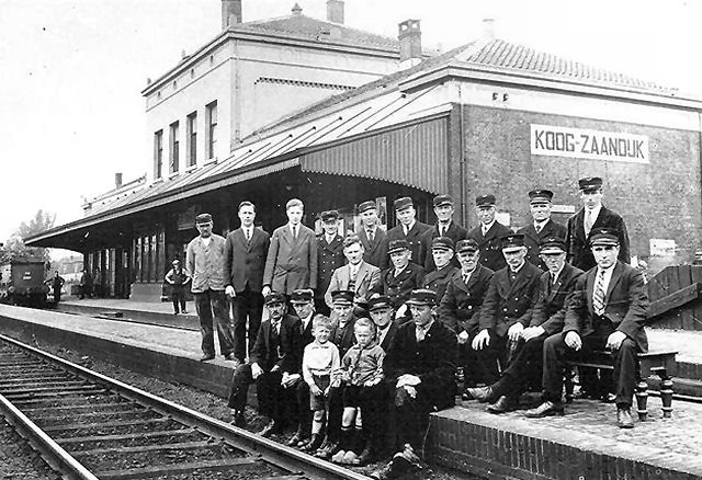

Project Dutch State Railway Station 3Th class
photo Zaandijk 1900 ( thanks to stationsweb)
Basis is one of the famous Dutch Railwaystation designed by van Brederode which where built from 1862 till 1868 in different cities such as Koog Zaandijk ,Wormerveer,Krommenie-Assendelft,Assen, Heereveen, Hoogezand Sappemeer, nieuwe Schans, Hoogeveen ( see stationsweb }
