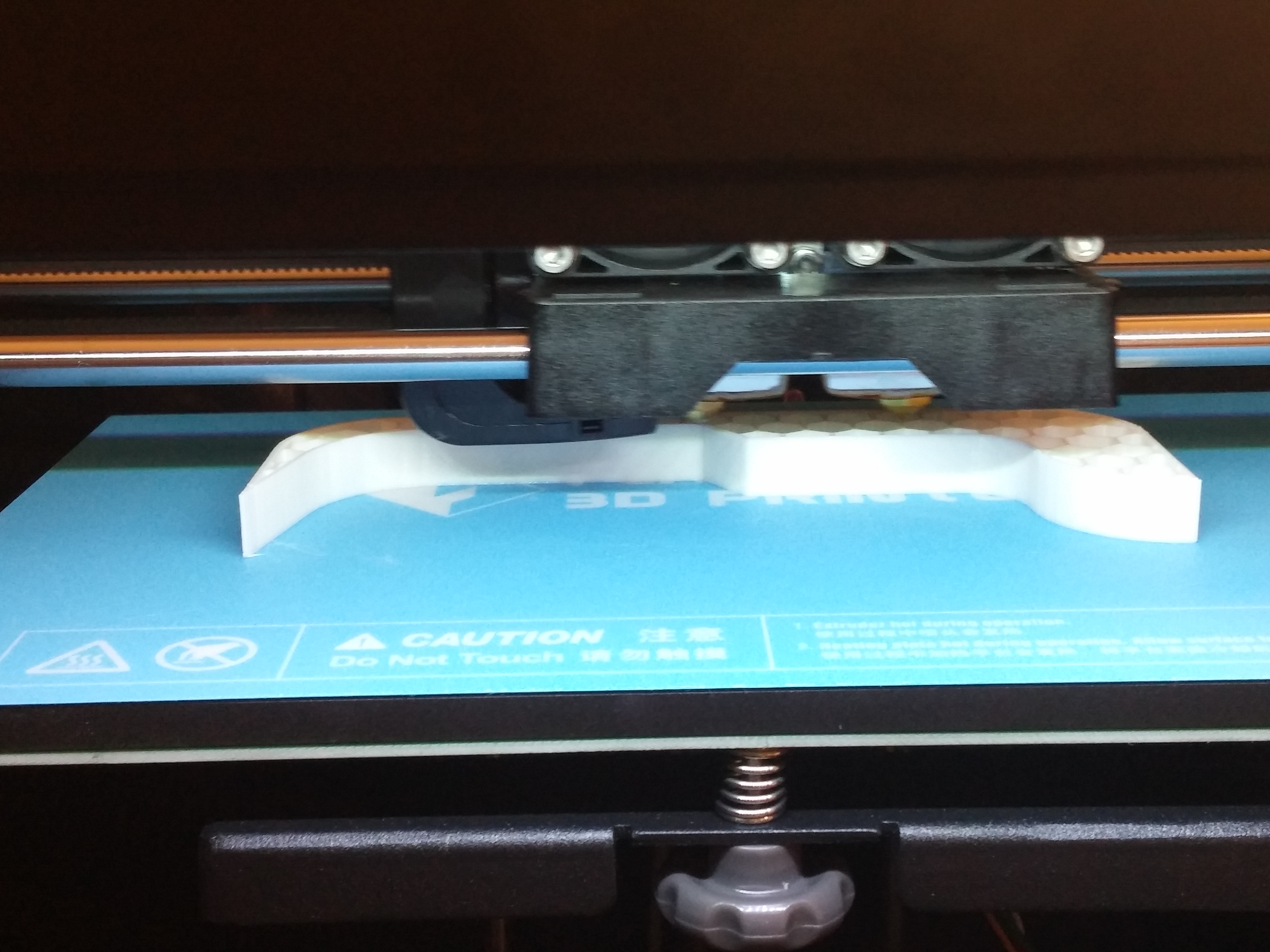

I got Flashforge Creator Pro From Amazon 3 weeks ago. Since then i have problems with printing.
O larger larger prints then test part they are not sticking to bed on left side. See picture. I level bed hundreds of time wit same result. I am printing only on right extruder (ABS 230 and 110 on the bed). Left draging my prints but this is another story. I try to resolve one problem at the time. Anybody can help me with it please.
How are you leveling the bed? Can you try printing just the first layer with no raft and take a picture?
the blue sheet is .2mm thick, it is still better to use a sheet of bond paper .1mm thick. Try it, it works for me.
It’s not teflon (which wouldn’t stick at all). It’s either polycarbonate or painters tape. It looks like the polycarbonate sheet in the picture.
I think the left side is either too low, or there’s cool air coming in the left side.
Keep in mind that ABS really wants to ruin large parts. It is trying really hard to curl because it is design to shrink out of injection molds. The best way to prevent the cooling is to use a heated chamber close to the Tg temperature of ABS (like in a StrataSys printer), but you can’t do that with a hobby printer because there are parts in the printer that will soften at that temp. So what we do with a FlashForge is have a heated bed and close it all up and hope for something around 50C in the chamber. Which isn’t really hot enough to prevent warping, but will sometimes work if you have good bed adhesion and your part isn’t too large. And no drafts because you want it to cool as evenly as you can manage.
