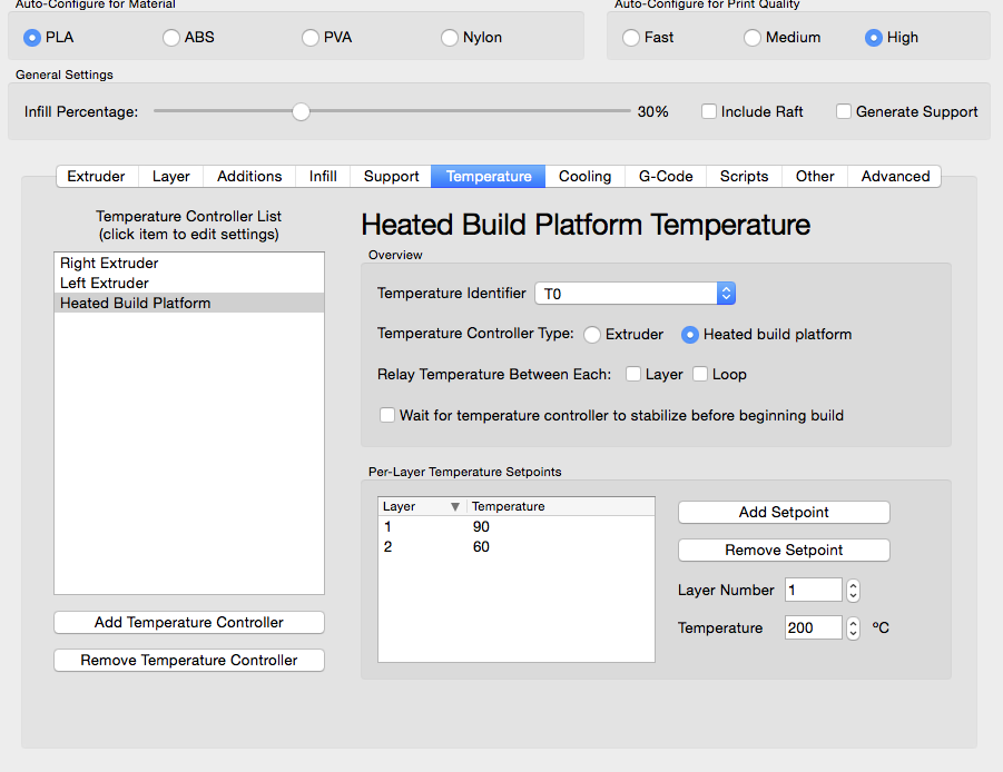

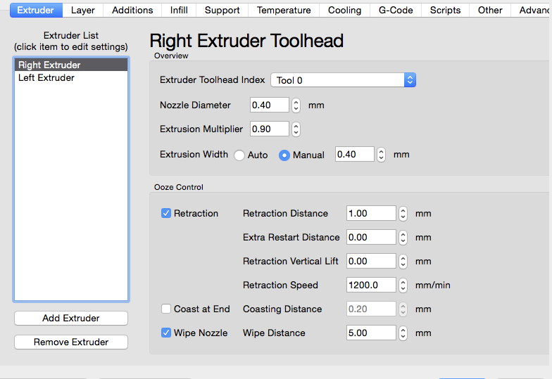

Hi guys thanks for the replies I tried the glass bed with printers tape…and success(ish)! It sticks and finished a print.
I have only tried PLA at the moment but it seemed to work.
I had the bed to start at 40% speed for the first layer with a bed temp of 90 degrees then to drop down to sixty and seemed to work, however the prints seemed to stutter towards the top and left boogers everywhere(see photos) any ideas?
Photos of print
https://dl.pushbulletusercontent.com/2r586vGD7ixoaBiweaN2RrMZg9WmQ4tI/IMG\_20150404\_183628.jpg
https://dl.pushbulletusercontent.com/wwDuQU9JXjOkDuUsFaWVVD8QNZLTQ7Dw/IMG\_20150404\_183604.jpg
https://dl.pushbulletusercontent.com/PJfvEVpN51kYRIRDF5cutDe8911ZCCLE/IMG\_20150404\_183558.jpg
Also in turns of settings heres just a few if need more please let me know
