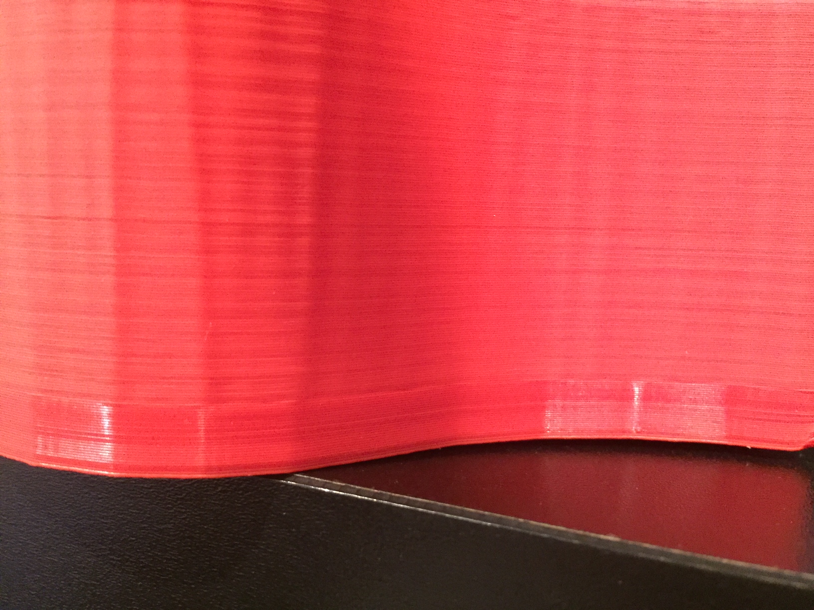

This is a change in temp issue of some sort.
Typically PLA is shinier when it is printed warmer.
Could be: Heated build plate is heating up print.
Fan settings for first few layers…
Check the cooling settings in your printer software!
