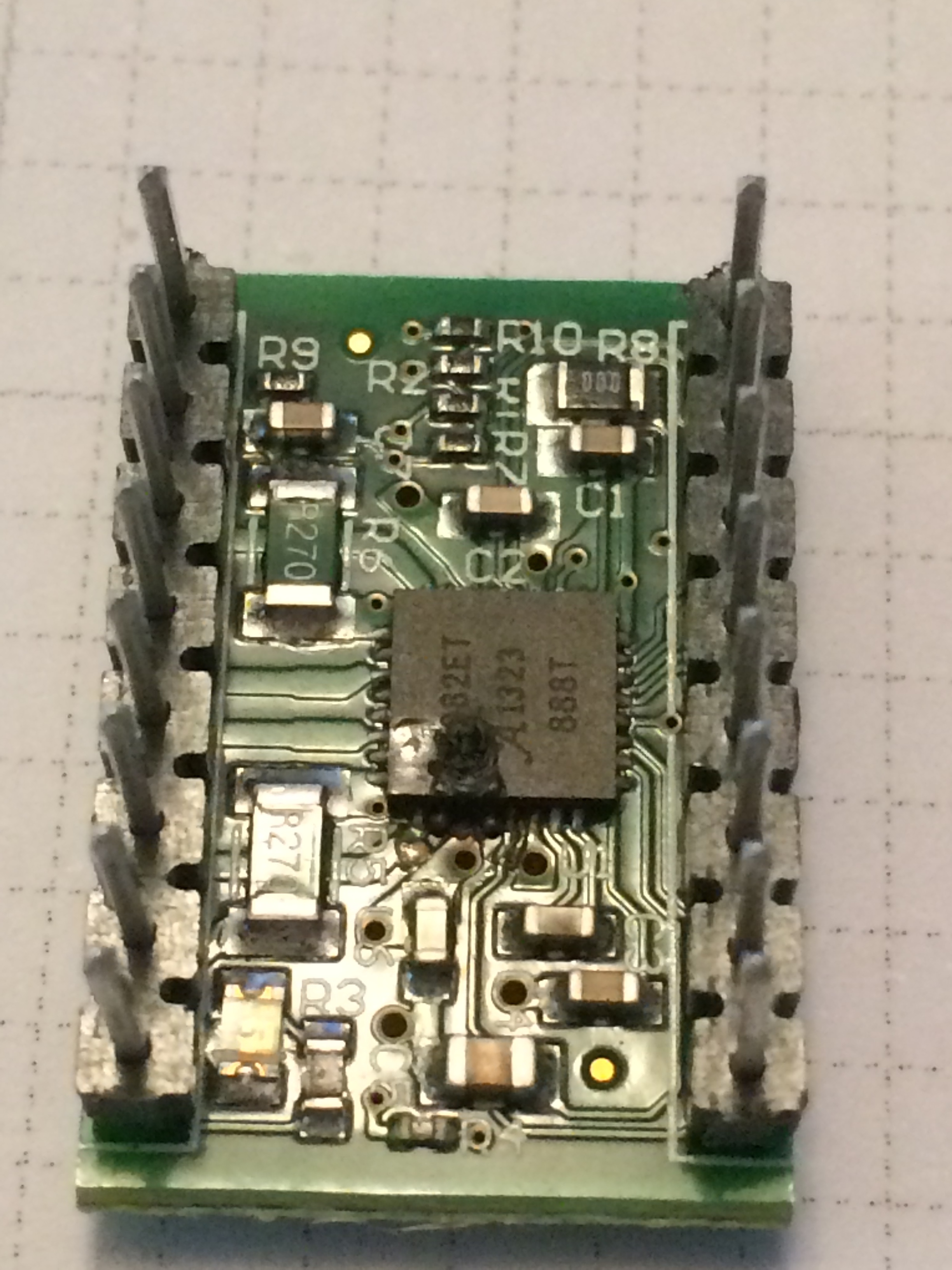

WOW! I am very impressed with the response from this site! I wish Makerbot was like that. Thank you all for your input. Here is what I have so far, 2 blown motor control boards. Now I am not through yet. I have found no issues with broken wires yet. After swapping my X-axis motor control board with the Y-axis, I tried to jog it and it will only jog (shaky at that) in one direction. I pressed both directions but it will physically travel in one direction. This tells me there is a power issue somewhere on the motherboard. Trying to find it now.

Okay if you have truly burned out 2 stepper drivers (not normal unless you unplug stepper motors while they are engaged) then you really have something strange going on! People talk about having issues all the time with all types of 3D printers but they really are not that difficult to repair. It is Makerbots right (totally sucks) to not distributed schematics to their boards. Look at all the clones of their devices out there. Yea their tech support sucks really bad but their are plenty of forums and even a Google group that are very active to help. You can pay for Makerbot support but until you get through all the first line support people to someone who really knows what they are doing you will be wasting a lot of time with “Did you reboot your printer” and “Pull the power cord and wait for 30 seconds” one of my favorites BTW! You need to either get active in the forums or Google groups or find someone with savvy electronics skills and talk to them on the phone. BTW power supply issues on the motherboard is highly unlikely as Makerbot Replicators have external power supplies. That brick you have to plug in supplies all the voltages for you electronics and stepper motors. Seriously save your money and hair pulling with front line support! There are many people more than willing to help solve your issues even people who would get on the phone with you!
Thanks for the input. I did a lot more research and found that Makerbot have, and has had, a design flaw in their motherboard. The 5v regulator faiks and allows 24v to go to all of the 5v circuits; therefore burning them out. This has been going on since 2012 and possible prior. They have had several board updates but they have not resolved this problem. Now with their customer support being a slow and grass growth, this means expect to have you printer down for weeks to fix this problem. I am going to explore alternative solutions to this but most likely will try to offload my Makernot to a comparable model from another manufacturer. It is going to be extremely hard the wash this bad taste out of my mouth!!

I would like to give everyone a very BIG caution about stepper motors. Stepper motors can act as generators. If you spin them when the power to the system is off, the steppers can generate high voltages. If you grab the print carriage with the power off and quickly move it, the potential exists to damage the stepper driver chips.
In other words don’t move the print carriage in either X or Y direction by hand with the power off. If you do make sure you do it very slowly. Voltage output appears to be a function of speed. A faster move can or will generate higher voltages.
