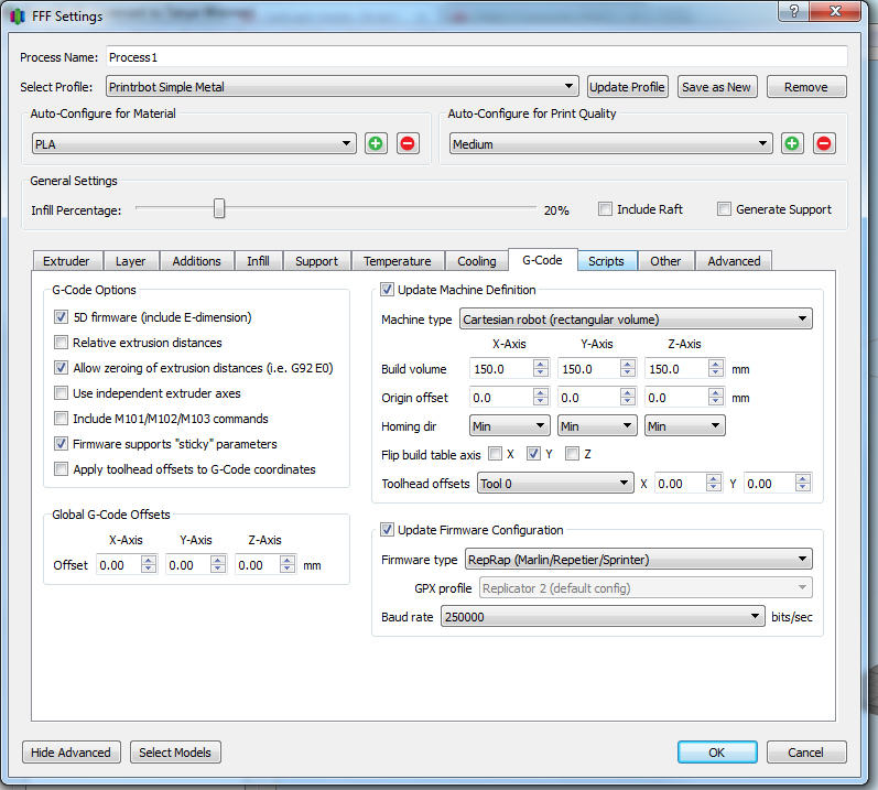

Could be as simple as reversing the XY axis… Under the G-Code tab (need to be in Advanced settings), check X & Y under “Flip build table axis”.

that help with it trying to go past the max x and y axis but it still digging into the bed and dragging across the bed. Could this be a issue with the firmware?
You may need to go through your Z calibration again. Sounds like your offset is too negative.
Try offsetting the z-axis under the g-code tab in s3d. I believe positive numbers will raise the extruder the amount you set when you begin printing.
I would suggest doing it through the terminal.
M212 Z
M500 to save
