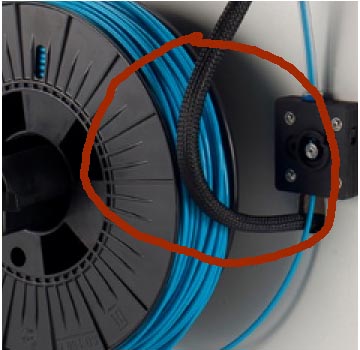

I’ve looked at the G code and there are no extruder retracts or Z hops near the locations where the defect is. The extrusion proceeds smoothly from the
sides right across the face where the defect is. The print looks like the extruder is starved of material in that zone of the print. Since it does not seem to
occur randomly but repeatedly in that one zone it might have something to do with the filament binding when the head moves into that particular location in
that particular direction at that particular height. Once the head is out of that zone the filament moves freely again and the starved extruder issue goes
away. My guess is the wire cable is stuck behind the filament spool and is causing drag on the spool and/or the filament path where it should not be. See the picture.
n23d
July 7, 2016, 1:38am
33
I drew a red circle on the picture but its hard to see.

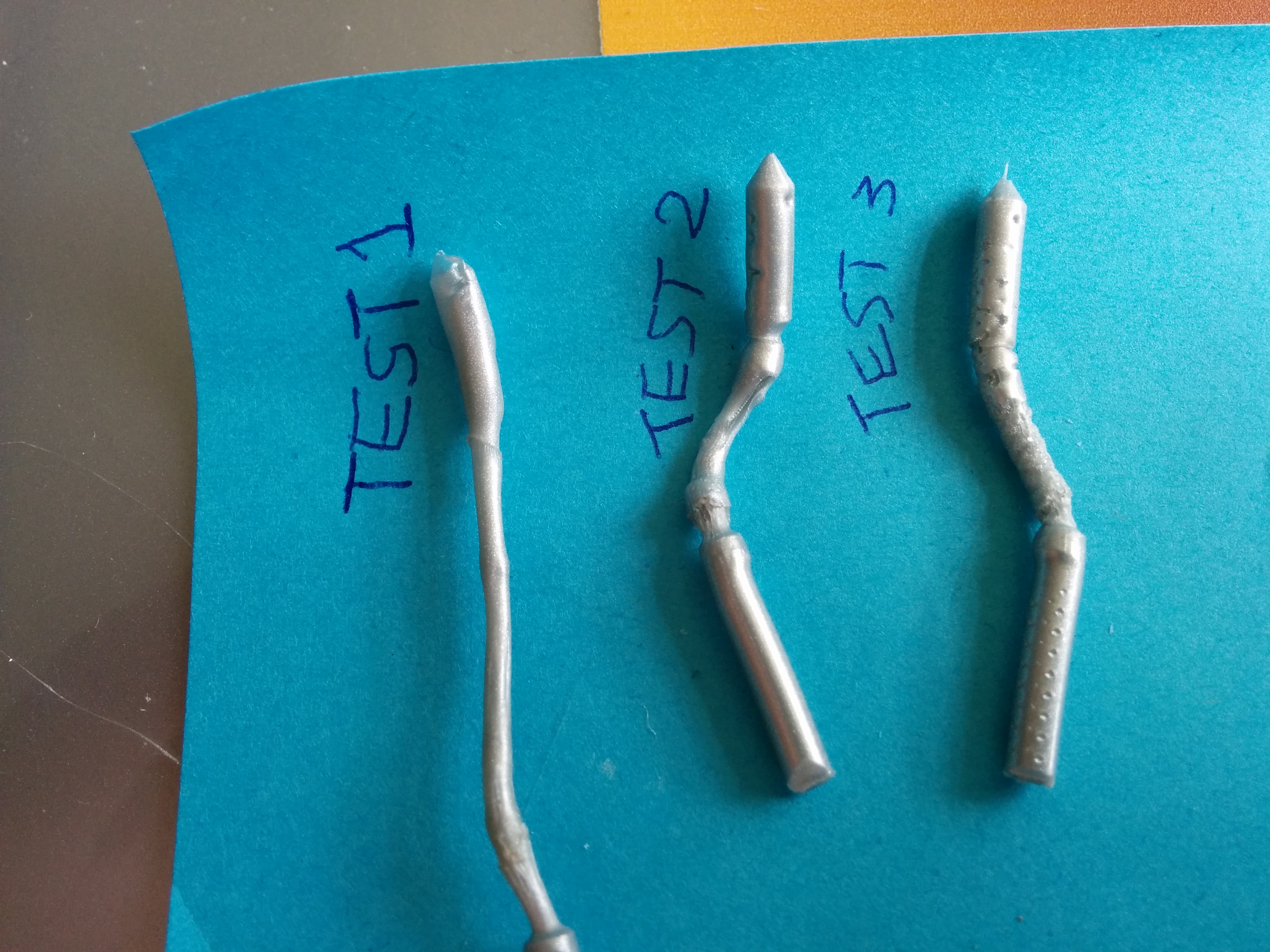

Thanks for your feedback, I really appreciate your effort! I’m having more issues with the Ultimaker 2+, right now it’s almost not extruding material anymore. The cable isn’t stuck behind the filament spool: I suppose that there is some kind of deposit of PLA inside the hotend. I tried the “Atomic Test” and that’s the result: as you can see, the issue it’s not in the nozzle or in the filament but somewhere in the hotend. I’ll check it and I’ll update you about the situation
