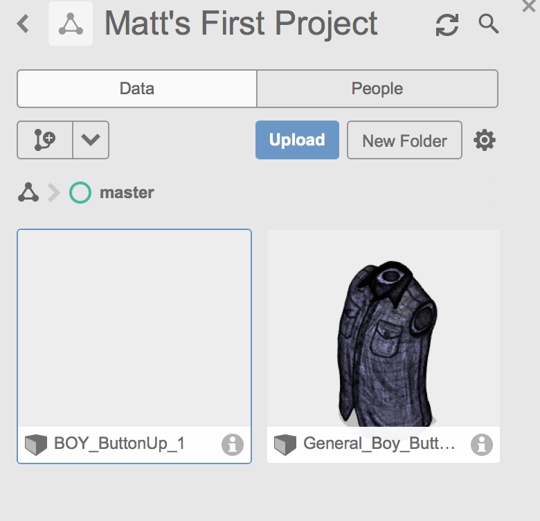

Now, I just uploaded my model and exported it as both an STEP and IGS file. But the exported files don’t show anything in the way of thumbnail images - they’re also very small. Is that normal?
I tried to reupload them to Fusion as well, to see if they would open, but they seem to be just blank files. I’ve attached a screen grab that has the OBJ file on the right, and the IGS version on the left.
Is there something I’m doing wrong? Or are these file types just not visual?
did you change the system units to match the imported file’s units before exporting?
I did not…
Is the dialog box on the right what you’re referring to? If so, is there a different setting I should be using?

No didn’t get your first notification. Yes changing those units should export the design correctly. That may be the reason as to why you were not getting a thumbnail when exporting as the design was exported smaller than what it should have been.
Oh, awesome! I think that worked - I had it at mm instead of inches.
Thank you so much for your help! Would it be okay if I got in touch with you again on here in the future? You seem to know your stuff.
Actually, I spoke too soon. Apparently I exported the file as a F3D file, and THAT worked.
But then, when I tried to export as a STEP file, I got the same results - the export completed, but the file was empty when I tried to upload and open it.
Is there something I’m doing wrong? Do I need to change settings somewhere else?
Try converting the file inside the program to a Brep and then export. Convert STL to BRep for Editing in Fusion 360 - YouTube
Hmm. I tried that - the video was helpful, but I guess my file is too big or something? I got this error message…
Probably doesn’t like that your mesh is high poly and not made of quads. Maybe https://www.freecadweb.org/ that @Modellus suggested can convert the higher poly designs better?

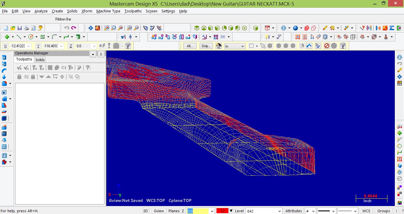

Is it possible to turn a digital scanned stl model into a solid for machining?. It is full of faceted surfaces.
