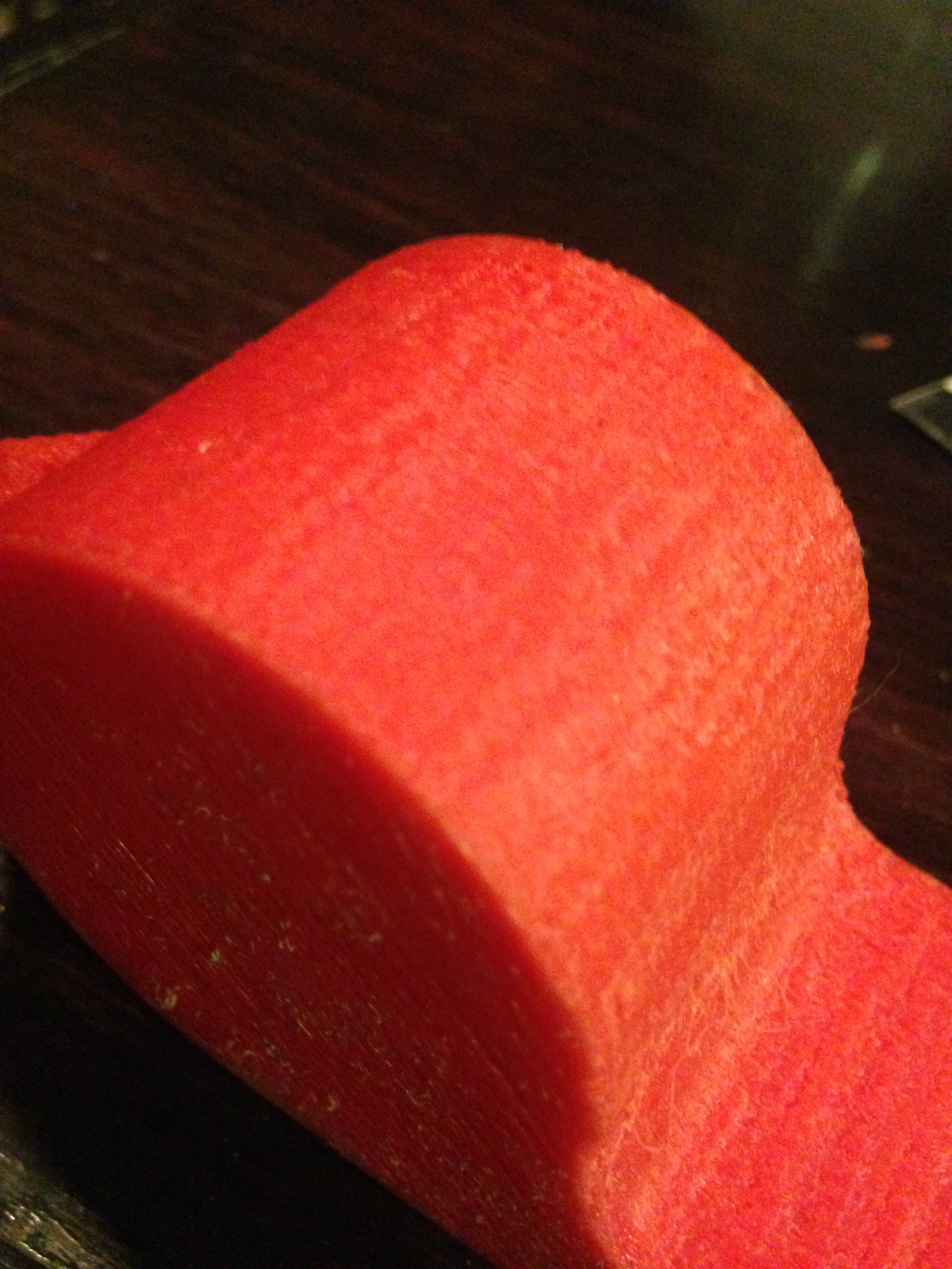

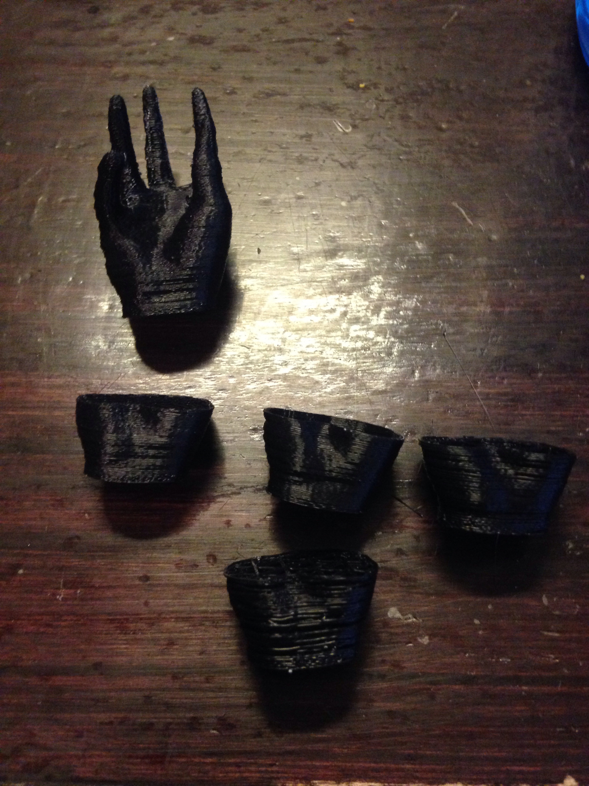

Print with reduced flow rate, this is also called extrusion multiplie, your extruder extrudes too much filament, also you could try to print with reduced temperature to reduce stringing. -Marius
If you are trying to print with 10 microns resolution - 0.01mm you better give up OR find me in skype: petarvmm to explain: even if you can print with this resolution the G code sometimes can’t slice the object very correctly depence of the model and the original size of the object in STL or other formats. If it is possible please read about temperatures extrusion for different materials, Also quality depend on fan speed and travel speed, check and try also to lower the temperature and lower the flow of the material a little bit.
