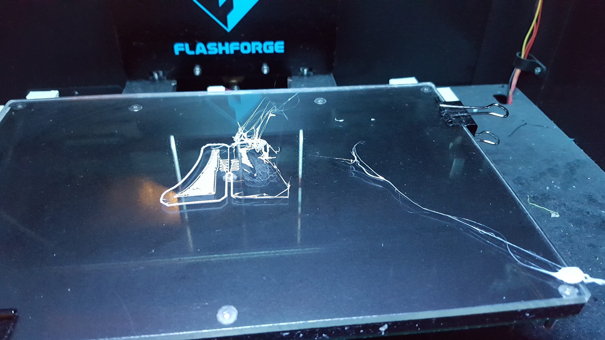

I tried to print 75-85C bed and 225-235 head but very bad result.
I used 3dlac or elmers purple and fan speed 50-100.
aero3D
I use Colorfabb NGEN on my U2 with settings as below using 3DLac and it is perfect every time. No lifting, warping and very clean print.
HBP: 85c
Extruder: 240c
I use ESUN ABS + , with 3mm Ordinary Glass plate on top off my Heated bed. Settings are as follows :
Extruder : 230C
Bed : 110C first Layer, 100C second Layer
Fan Cooling : 100% after the forth layer
Been getting amazing results lately .

I have problem with spool holder. Thats why not working.
