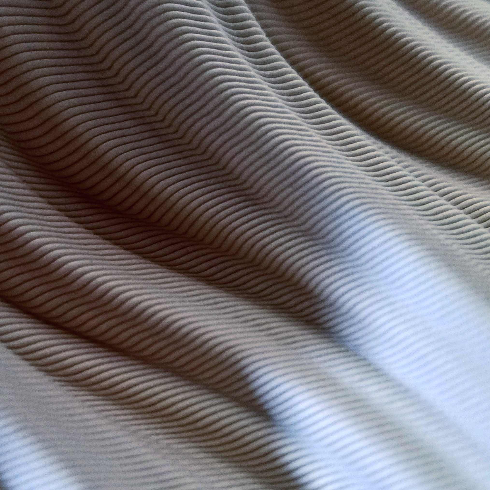

here is a sample of one of my prints

Here is a close up of a Julia vase print. Very pleased!
