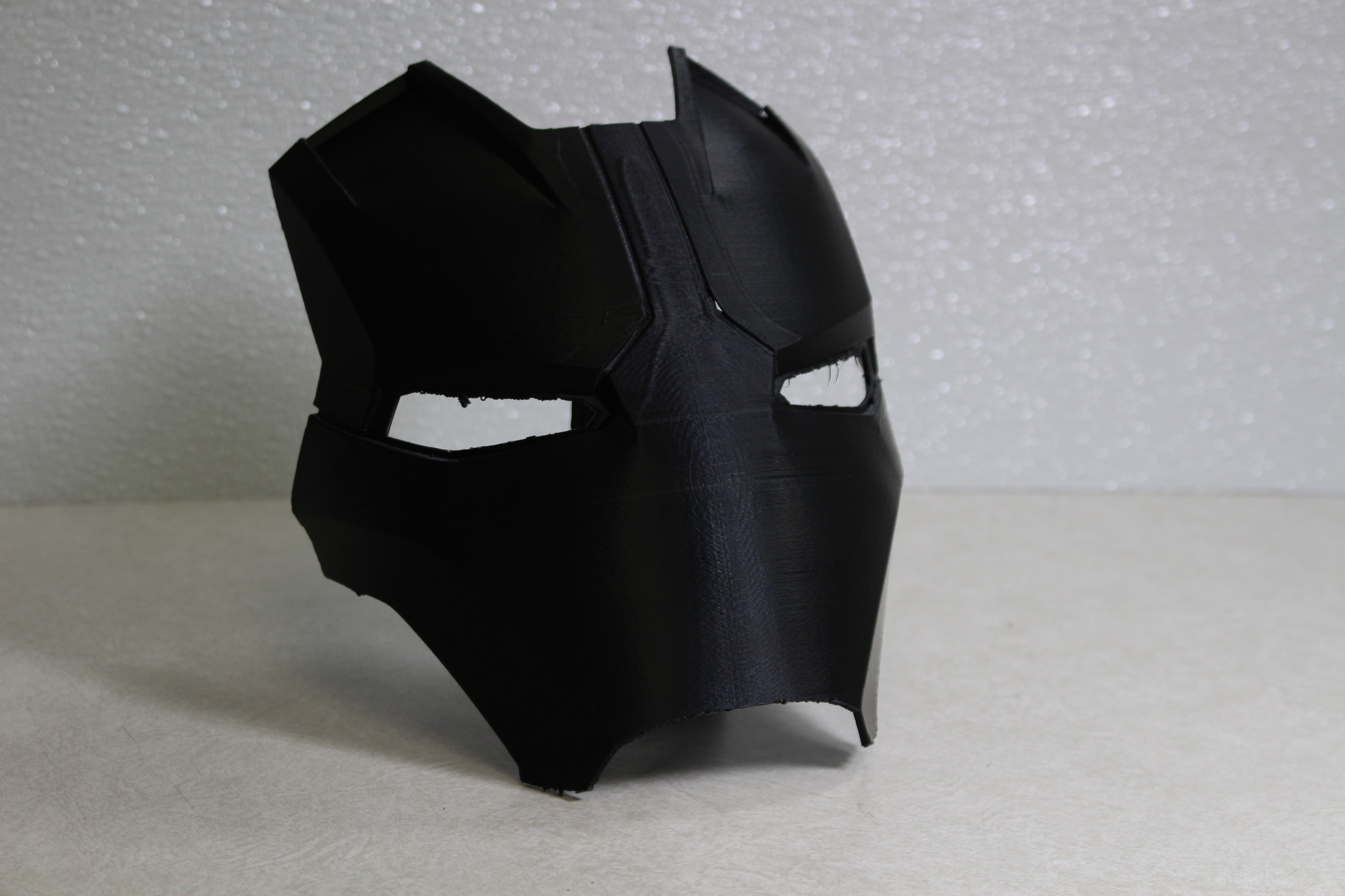

I think the trio is a great printer, however I would not recommend it as your first printer. It does have 3 material printing capabilities, but it come standard with one, so you have to buy the 2 other extruders to have that upgrade (which you can install your self or pay extra upfront). Its not cheap by any means. It produces a really great quality print (will upload an example, to get an idea of the scale, its life size).
