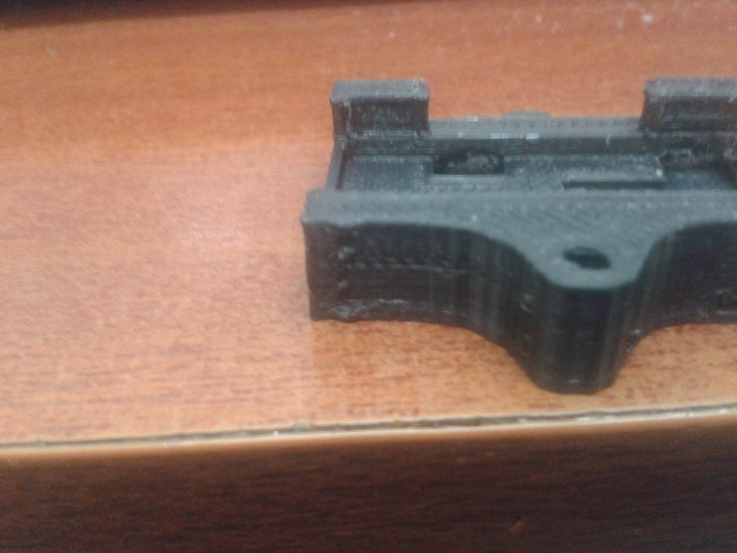

I’ll bet it came with a roll of abs. Pla smells sweet. Your print looks like abs. Heat bed temp should be 110. I know the rolls are not marked and can come with abs or pla

ABS will dissolve in acetone, PLA will not. I have not heard any one else report mislabeled filament from CTC. Again from those pictures, this is clearly a user error issue, OP needs to learn how to calibrate the slicer. Follow the instructions laid out in sailfish manual.

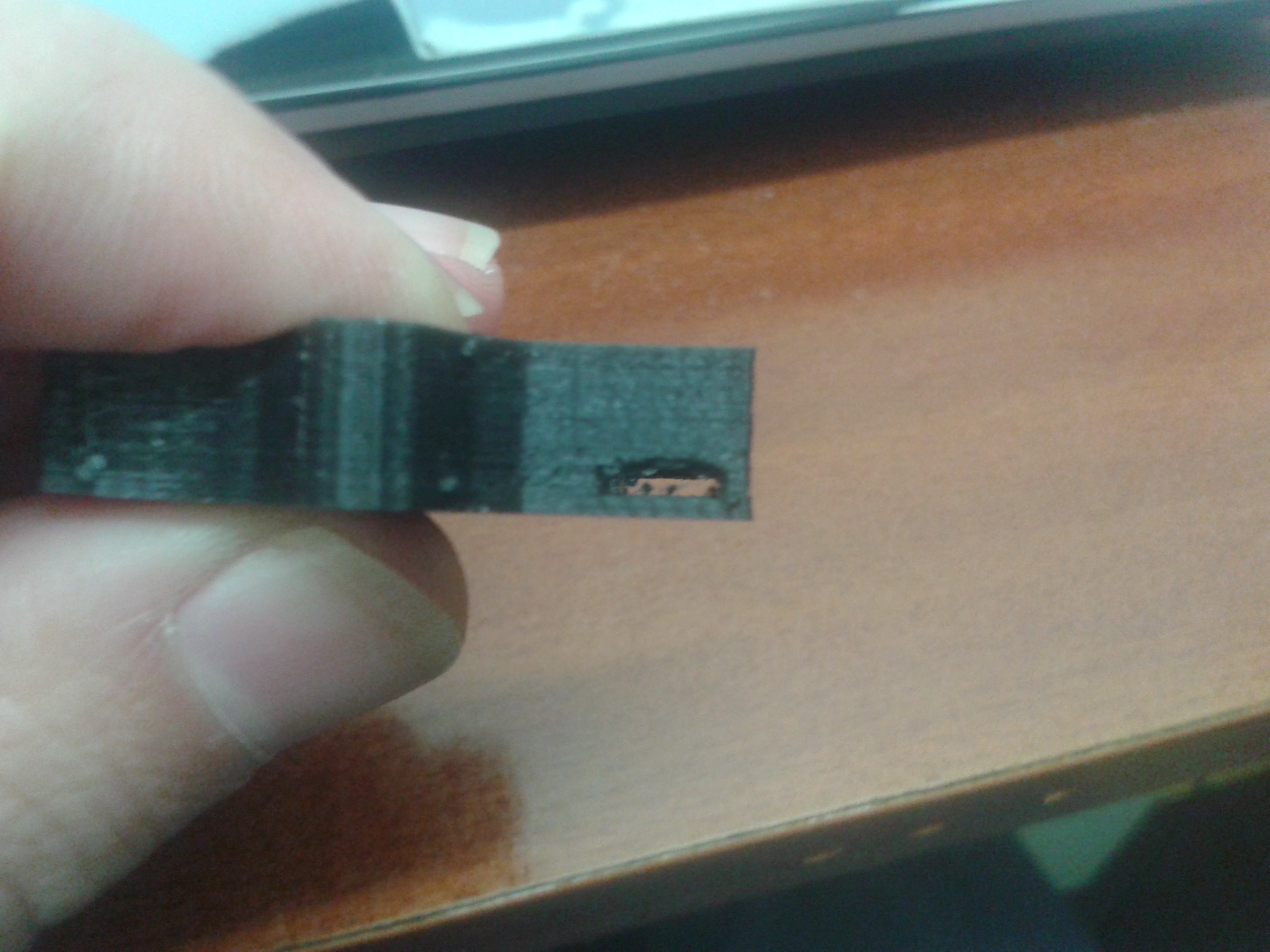

It PLA ive tested with Acetone and dident dissolve… Here is a new print… temp used 240 heat bed 55 using makerware 2.4 i had to sand some excessive material in some places to look like this.
In the picture showing the first layer, it looks like you’re not trammed proper. It’s very squished in the corner and then the stands are not touching further on the solid layer. What do your calibration cubes look like. I also see over extrusion. What is your filament measuring to actually?

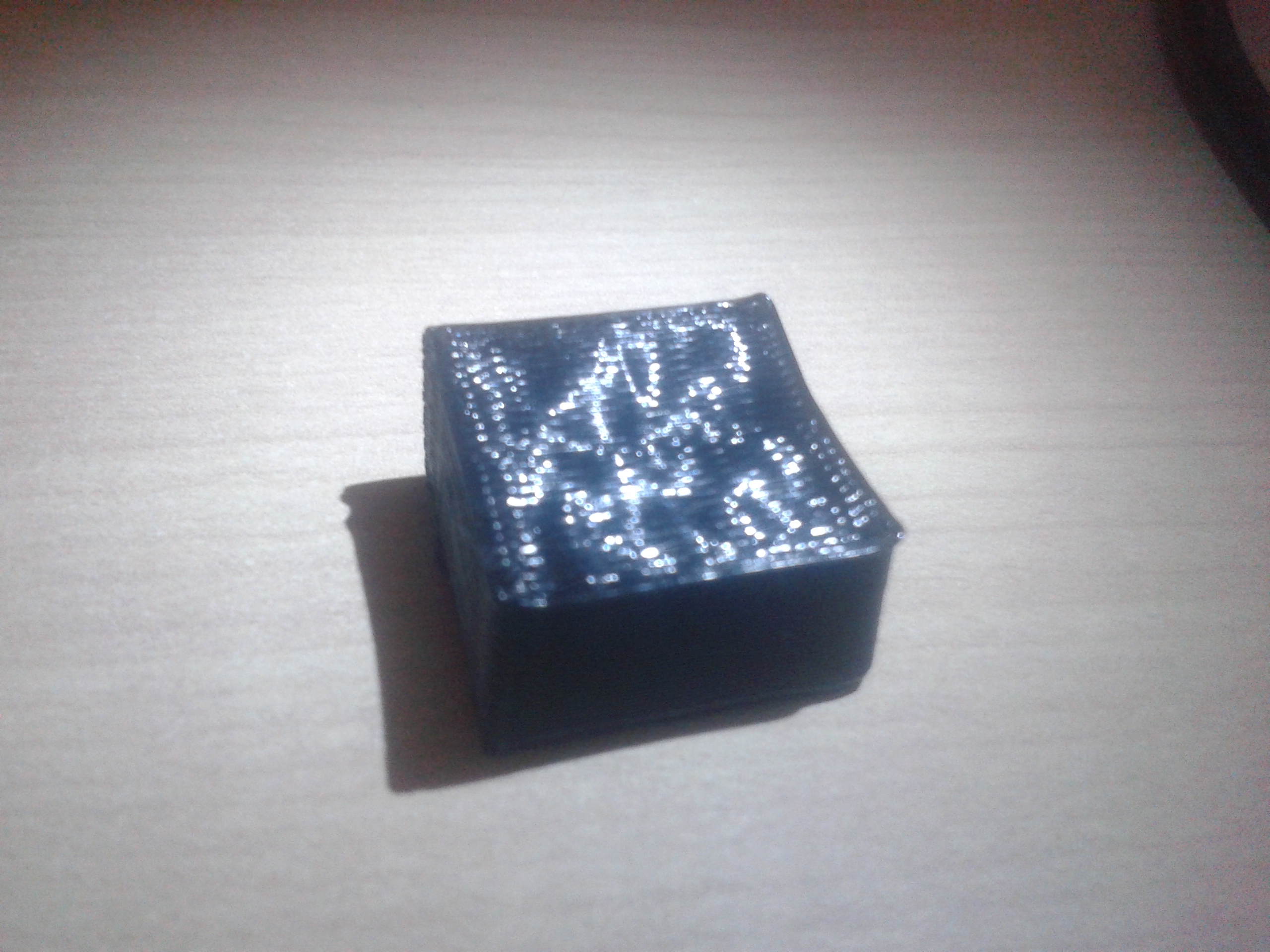

hello… the filament is 1.73 and 1.75 measured with caliper… upladed some pics of the cube…

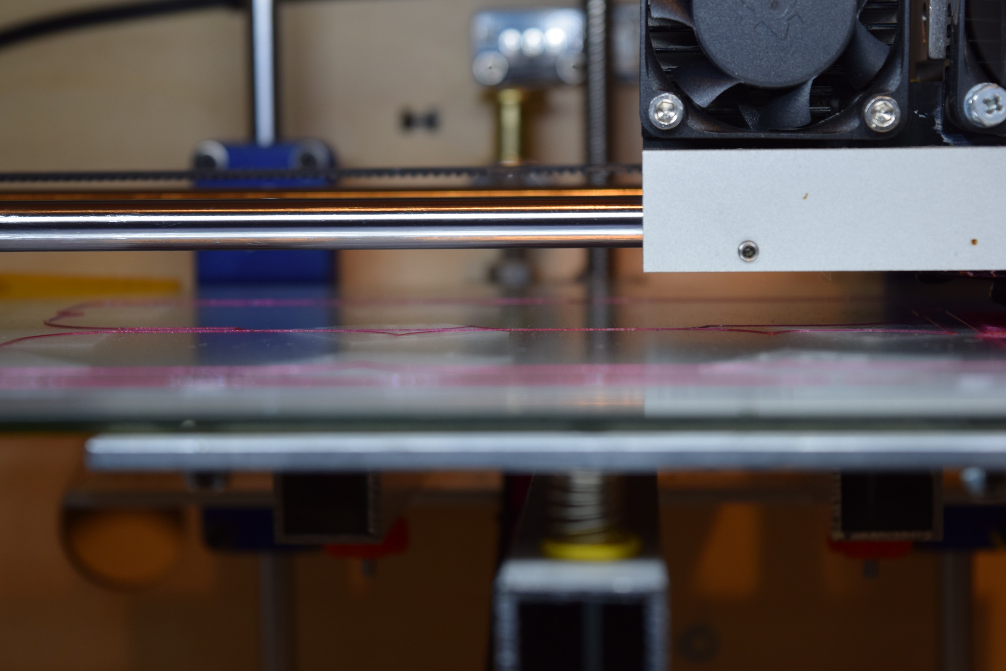

is that 100% infill? first issue is temp. it is way too hot. the severe deformation is a really good indicator of that. A good visual temp indicator is the prints luster. A more matte print indicates a low temp, while a glossy finish indicates higher temps. For PLA test cube, especially on your printer with no filament cooling, print two at a time on opposite sides of your build platform. This will allow each individual layer to cool before adding more molten material. This is very good tip while trying to print marvins. What is your first layer settings? I think the pics #5&6 are the bottom of the cube? you might be too far from the nozzle, but regardless there is too much plastic coming from the nozzle. I will grab a pic of my test cubes in a sec. I did photo my first layer of a print i started this morning. What your seeing is a skirt. This is an outline of the entire print job. Notice how the thickness is the same all around. just a little flattened by the nozzle. This is magenta PETG filament from Esun.
