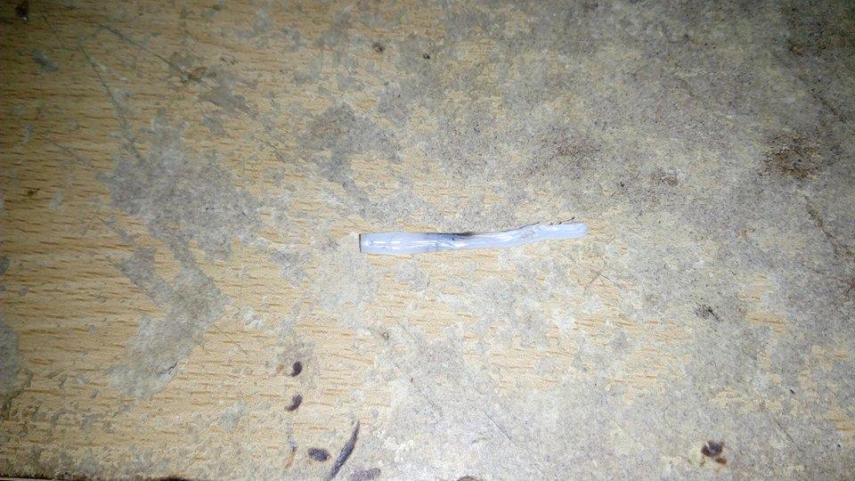

You need a PTEFE Tube with 3mm Outer diameter and 2mm inner diameter. About 3€ on Ebay/m
Hey, I’m also waiting for an order on PTFE tube from Ebay, just to have around as spare. I’ll only know for sure if it’s the right size once it arrives which should be still this week, but for reference, this one is the one I ordered:
PTFE Teflon 2 x 3mm
The inner diameter is 2mm (to handle the 1.75mm filament) and the outer diameter is 3mm, in order to fit the nozzle (I hope). Previously I got another PTFE tube which was for 1.75mm filament and it didn’t fit - inner diameter 2mm / outer diameter 4mm.

You can’t run without the PTFE tube. It acts as a guide down into the nozzle. If you run without it, the filament will just flex in the heat break, twist and jam.
The only way to get rid of it completely is to replace the heat break with to a version with a 2mm hole down the centre and nozzle with a 2mm hole and make sure when you assemble that you tighten the heat break and the nozzle very tightly against each other to stop molten filament from spilling out between them.
This happened on my E3D Clone and it was a sod to clean all the cold filament from the hot end.

Hi, the new tube arrived yesterday and it fits nicely, matches all the comments and suggestions from the other posters in this thread > http://www.ebay.co.uk/itm/151280480493?\_trksid=p2057872.m2749.l2649&ssPageName=STRK%3AMEBIDX%3AIT

It was from that I persevered with it, I replaced the stock fixed extruders with spring loaded ones which has solved the skipping on the filament. I replaced the PTFE tube with that which is 1mm longer so that it’s compressed in the thermal barrier tube, no more clogging or jamming.

The thermal barrier tube is held by a set screw. Unscrew that and take it out you’re done. Btw you shouldn’t mess with ptfe lined tubes…AT ALL… EVER. There’s no possible way to print reliably with this printer unless you get threaded thermal barrier tubes with no ptfe, and with thermal paste on the cold side of tyre tube ( not the side that screws into the heater block) , and thermal paste where the heatsinks touch the block. If you stick to ptfe lined barrels all I can say to that is good luck!

Does anyone know how long the tube is supposed to bet cut to?
34mm + or - 1mm
My new CTC (one week old) clogged last night. I just removed the tube completely. It still printed just fine. I had done the same thing to my Da Vinci 1.0 and it always seemed to work fine.
I guess I’m only risking clogs.
Don’t remove the tube. Buy a new one and put it in there if not you will have nothing but clogs. Also a but of baby oil helps a ton. I usually have it on a lint free cloth piece and when the filament is being pulled it passes by the baby oil just enough to keep things lubed. Not really needed for oily filaments like abs, but pet, pla, XT and so on do need it and makes it print very smooth. Haven’t had a clog since I started doing this baby oil trick.
More tube on the way. It’s out for now because it’s mangled.
