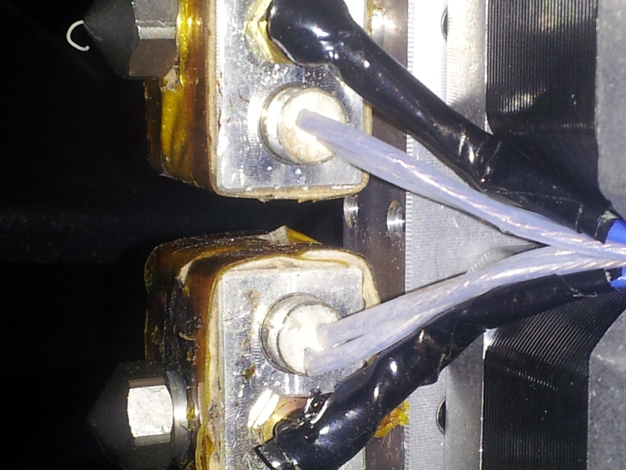

Well it definitely seems like the firmware, motherboard and thermocouple is working. Since the right extruder is not at the correct temperature the thermocouple is telling the motherboard and hence the firmware that it needs to supply more current to heat the hot end some more. What seems odd is that you are using more current on the right hot end than the left and yet the left hot end is reaching a higher temperature. Since you have ruled out the heatsink thermopaste we seem to of isolated it to the heating element in the right hot end. I would say that maybe by switching to a full metal hot end it put more stress on the heating element which caused it to fail. Since after reading multiple places and having the same issue myself with a full metal nozzle, having so much metal causes the hot end to become a heatsink making the heating element stress more to maintain temperature. I’ve noticed this when converting to a full metal nozzle where with a brass nozzle I could get to 260 degrees without issue, I couldn’t even make it to 250 degrees with the metal nozzle. I have a hunch that the heating elements arent the best on the flashforge and that’s what you are running in to. I would propose one last test and that is to replace the PTFE setup (only on the right hot end) and see if you can achieve the correct temperature. If everything is exactly as you had it before switching to the full metal hot end and it still doesn’t achieve the correct temperature, then I would say that at this point it is definitely the heating element. Would you be able to submit a picture of the wires on your hot end for the right extruder?

Picture!
The one with the white abs is the right side
You would definitely be able to get to 260 degrees no problem. Just make sure the motherboard can handle such a load. Try asking the company selling the 80w upgrade if the mighty board on the flashforge creator pro can handle the current draw for it. I’m thinking of upgrading my hot ends in the future too because of the lack of heating with metal nozzles. If you do end up upgrading to the 80W would you mind posting to update me on wether it solved your problem or not. I want to see if the upgrade works for you and if it does I’ll probably join you on the upgrade.
The heat shielding kapton tape is intact so the heat should be kept in the hot end which is good. The wires to the heating element look fine too so it’s gotta be a defective heating element on the right extruder. Unless anyone else has any other idea’s I think it’s pretty much case closed and pick up a replacement hot end for the right extruder and it should solve your problem.

After thinking about it, if both are pulling the same current, and one gets hotter, it has to be a heat sinking problem. The law of conservation of energy says the energy has to go somewhere, and it apparently isn’t staying in the hot end of the setup, unless the thermistor is lying.
You know what you have a point. Don’t know why I overlooked that fact. It is getting slightly more current than the left extruder so it should be getting just as hot as the left assuming nothing of the right extruder is different than the left. In that case a faulty thermistor which gives an incorrect reading would definitely lead to this issue. The only way to verify this is to switch both thermistors and put the right thermistor in the left hot end and the left one in the right hot end. Good catch Ed!

I’d agree with this except that when he tested both the voltage and current to both nozzles. The right nozzle ( the one that doesn’t achieve the desired temperature) does get the same voltage but more current. So in theory it should be hotter than the left nozzle. The running idea is that the thermocouple is not telling the truth for the right extruder. it seems that is causing the heating element to continually use the same current as if it was heating from cold start. The only way we can check is to swap thermocouples from left to right and right to left to see if the problem goes away in the right extruder but presents itself in the left. If that’s the case then we identified the problem to be the thermocouple.

I would try swapping thermocouples and plugs at the PCB to see if the problem follows to the other side while heating, that way you know if it’s a faulty thermocouple or not.
Likely, you have broken your heater cartridge when doing the replacement. They have very tiny wires, and are very delicate.
If the same current and voltage is flowing into both heaters and one is hotter, either the themocouple lies, OR the heat is going somewhere it shouldn’t.

Swapping components is a good way to troubleshoot.
I agree with you on that one. Try swapping the sensors to test them and you should see if the problem moves to the left hot end after the swap.
