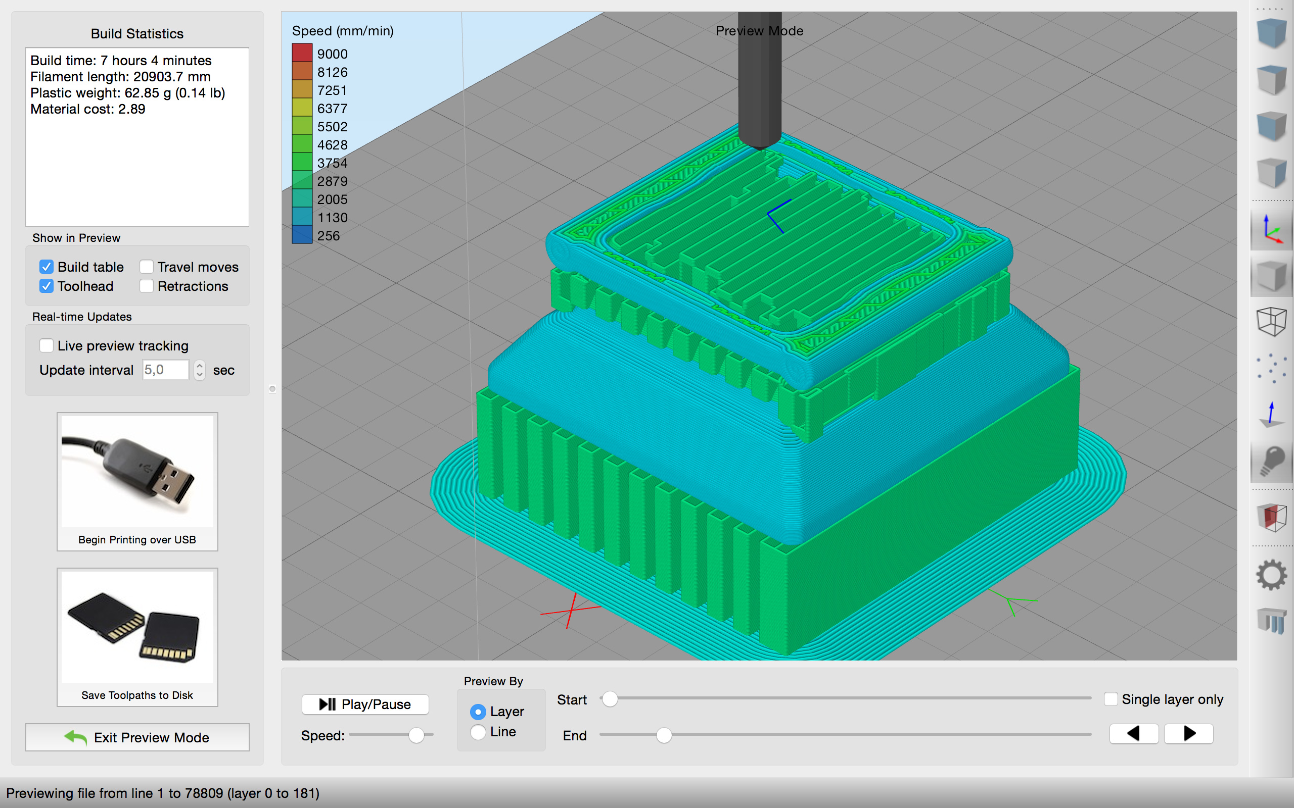

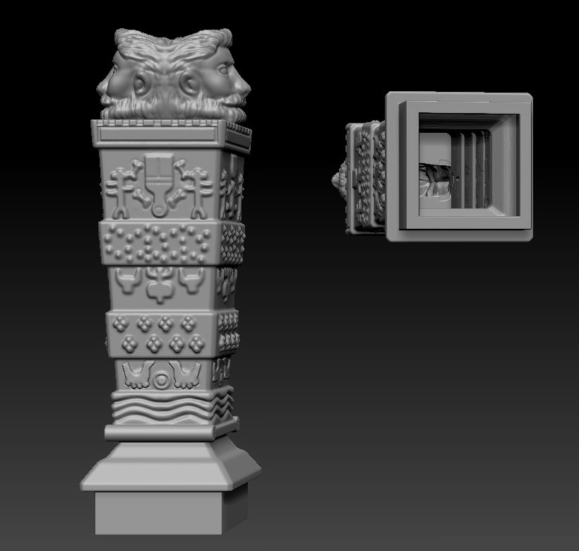

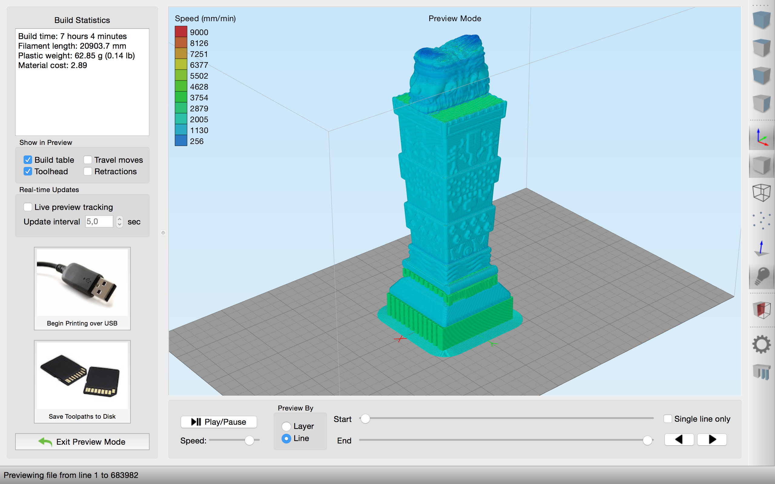

Good question, I was wondering that myself I know Elwin used white ABS for the model. And looking at the screenshot, the statue (tall part) was filled up all the way. Would be a bit of a pain to remove all that given the length of the top object. Although you could leave up in the 2 heads part…don’t know how about becoming brittle over time…wouldn’t be nice to find plastic among the ashes

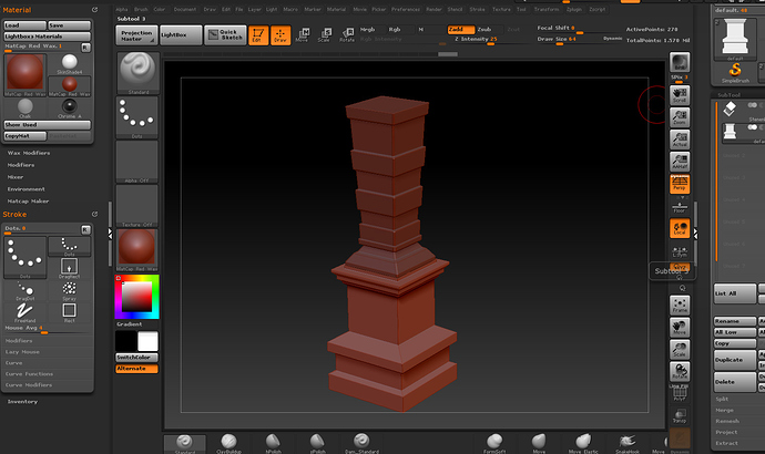

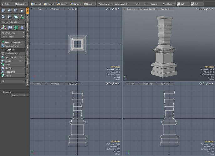

I really like Modo, I have been using it since version 201 I think. It’s very easy and fast to get some mockups done or just good modelling, especially with this kind of thing because I can use it’s metric system to size everything accordingly. I could do this in Zbrush but I find it much faster to just go into Modo and place everything exactly. From there on I have something that is consistent in size and proportion. All I have to after this is have fun in Zbrush. (although Modo has sculpting tools too btw! but in my opinion Zbrush is much more superior in the sculpting business)

For a project like this you would want the inside to be nice and clean… so, if Elwin used ABS support I am curious how he handled it…

I can definitely recommend it that you give it a try! I have used Maya and 3DS Max as well, although a long time ago and nowadays sometimes for extracting some models for games/scripts etc. The latest version (4R7) is incredible and 64-bit as well. These days I do a LOT in Zbrush only, I can prototype stuff really fast and most of all I can get detail in models like no other 3D package without crashing my system The user interface can quite daunting though…also, Zbrush has a bit of a different approach to modelling, it really is almost like sculpting. Thankfully, the new Z-Modeler is god-like for hard-surface modelling

Well, to be honest, you can’t really compare it I think. Rhino/Blender has the same basic thoughts on how to model stuff as Modo/Maya/3DS Max/Lightwave has… Ofcourse there are a lot of features in every 3D package that are mostly similar in usage and goal, and every package has it’s own field of area in which it excels a bit more then others. I use Modo frequently because of the ease and speed for which I can create something. Using Blender or Rhino has the same experience I think, granted you know your ‘stuff’ so to speak Shortcuts etc…
Zbrush works has also some same basics ofcourse since it’s a 3D app. The big difference is the mindset behind it. If functions more luke sculpting and reallife modelling (like with clay) then traditional modelling.They only thing, in my opinion, that has more advantage is the fact I can work with millions of polygons with ease and put in a lot of detail. Of the best features Zbrush has in, once again, my opinion, is the Decimation Master plugin and the Z-Remesher functionality. I can trim down a model from 10 million polygons to roughly 50.000 if needed and preserve detail. The Z-Remesher tool lets you do the same but calculates nice and even quad-polygon’s over the whole model. Besides that, the other remesh function lets you do booleans with ease, add and subtract whole meshes together, remesh it with nice geometry and voila! you got your watertight mesh ready for printing Ofcourse it takes a bit more careful planning with in a very tiny nutshell: that’s it!

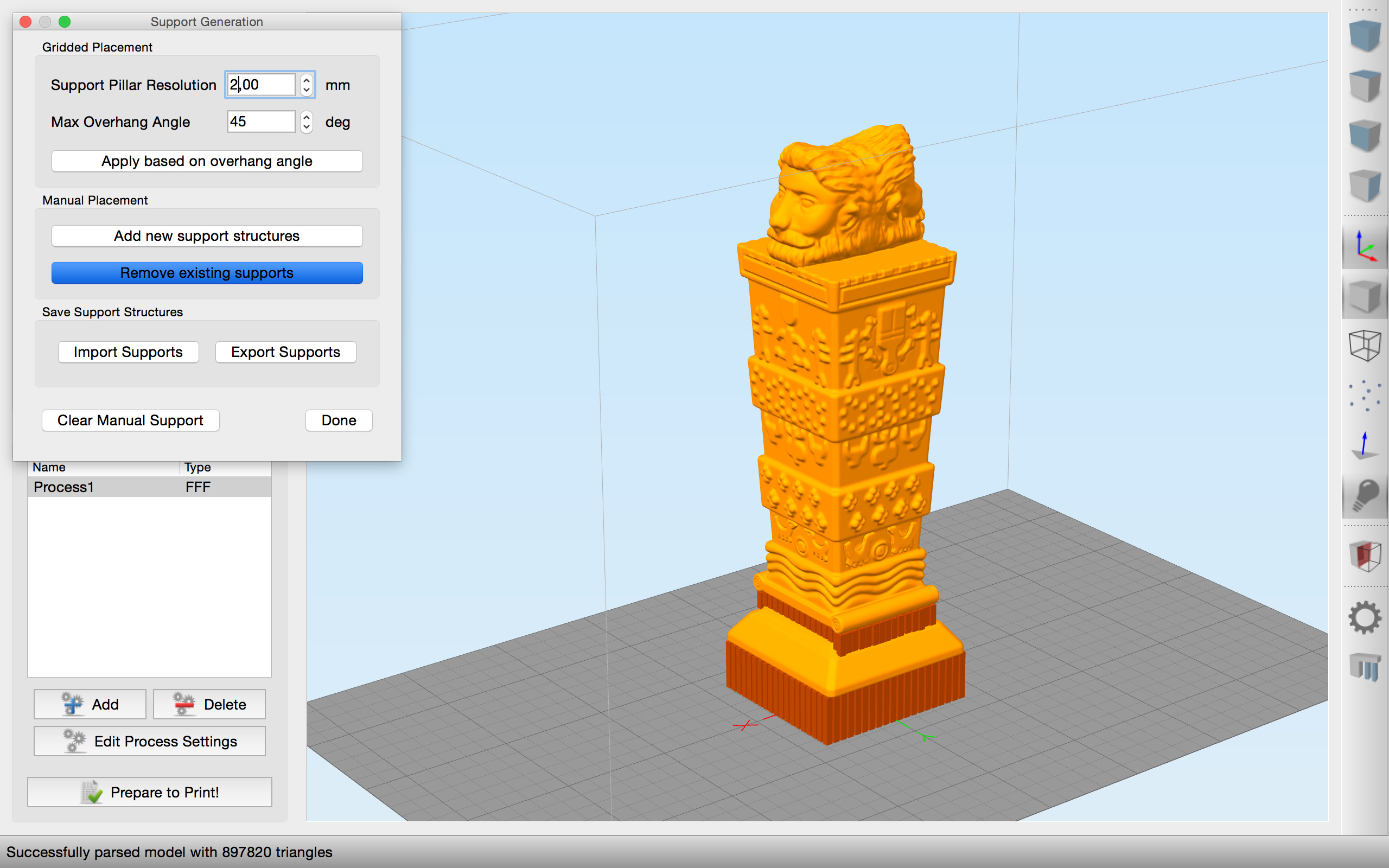

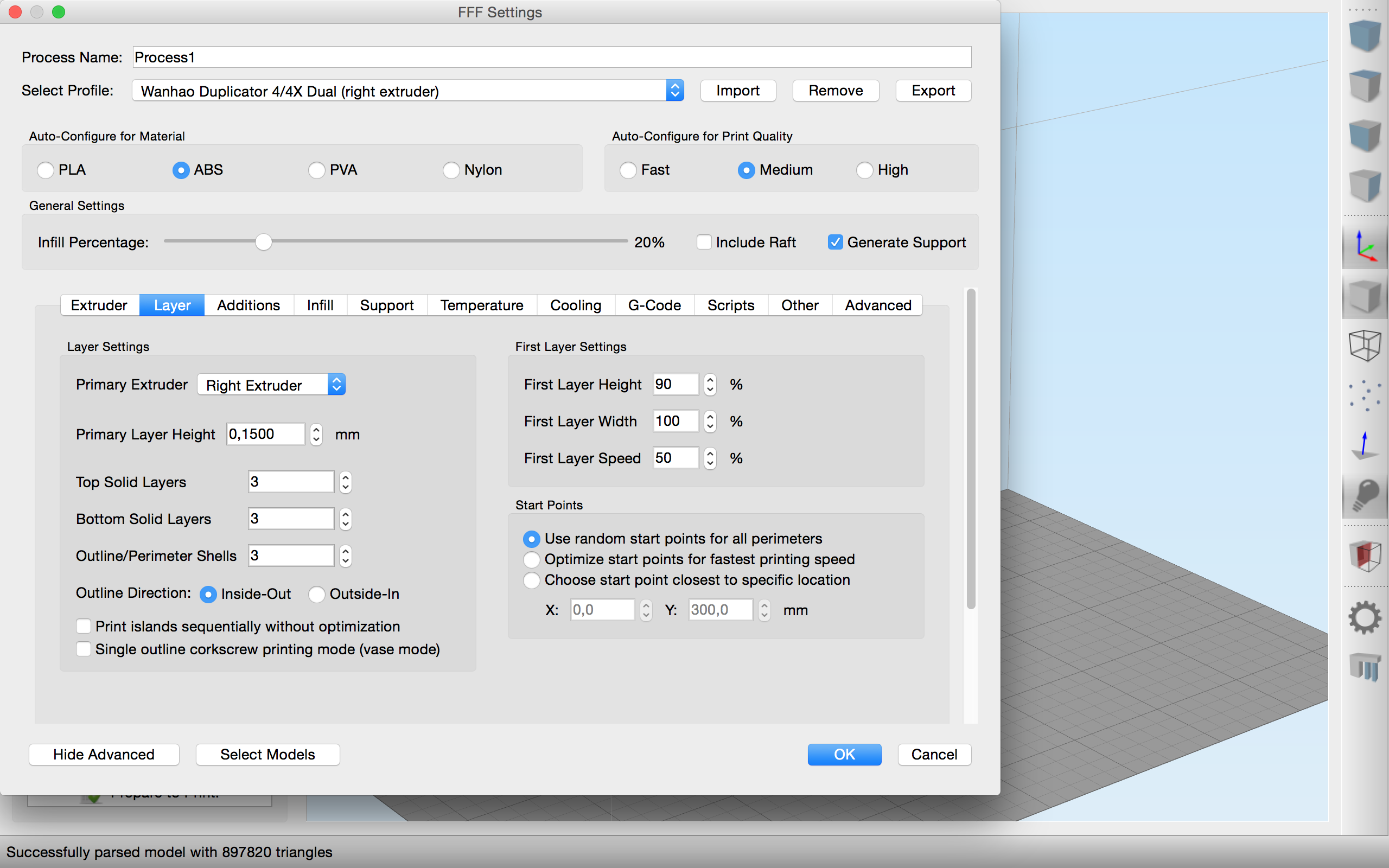

I did use ABS because i can’t get my second extruder dailed in good enough. There is always a bit of shifting compared to the other extruder. So if i would use PVA it would touch the outlines of the ABS wich would ruin the object. Thats why i only use one extruder.
I have to say that simplify 3D handles supports really Well and they are easy to remove with bare hands or tweezers.
I agree that PVA would be the best solution.
I do like simplify3D myself. Sorry to hear you cant get the dual head tuned. I have the duplicator4 also and it van be a hassle but i tweaked in replicatorg and i was able to get it right a couple of times. Unfortunatly you have to do it often and i haven’t tried s3D tot handle it. But good to know support like this can be removed easy. Thanks for sharing
