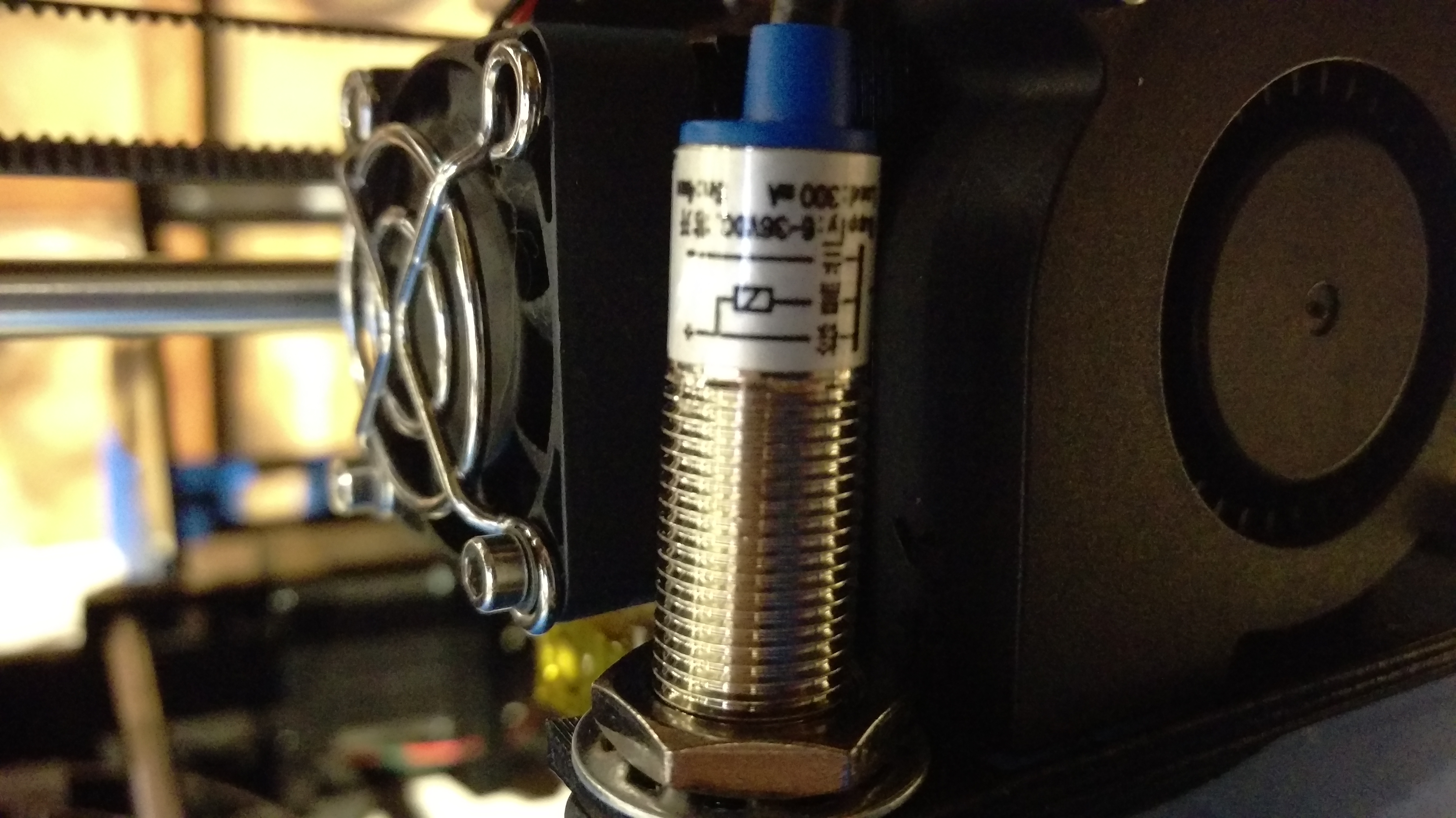

So I’ve actually managed to mount the inductive sensor onto my printer, as well as wired it up and have it working as a z end stop switch now, but still have a couple problems.
Problem 1: Whenever I home all axis, or at the beginning of the print when the print tells it to, the X axis as well as the Y axis home, but this leaves the Z end stop switch, or rather the induction sensor, above mid air. This is a real problem as now the sensor has nothing to tell it to stop moving with and if I dont stop it manually it would just go down until the point where it broke my printer. I’ve tried looking into changing the firmware or the EEPROM and many other solutions but to no prevail.

My Inductive sensor:
