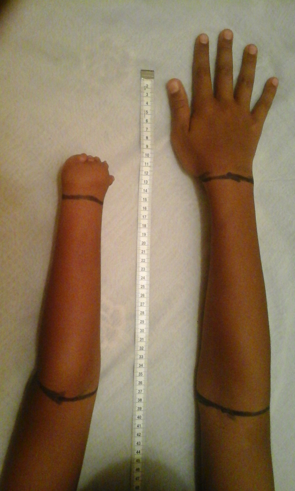

I need help about a particular request : My nephew was born without finger on his left hand.
I’ve seen a TV dicument talking aout the 3D printer making it possible to build an artificial hand.
Are those projects handled by someone of you please? If so, what do you need to start the project and how it costs approximatively?

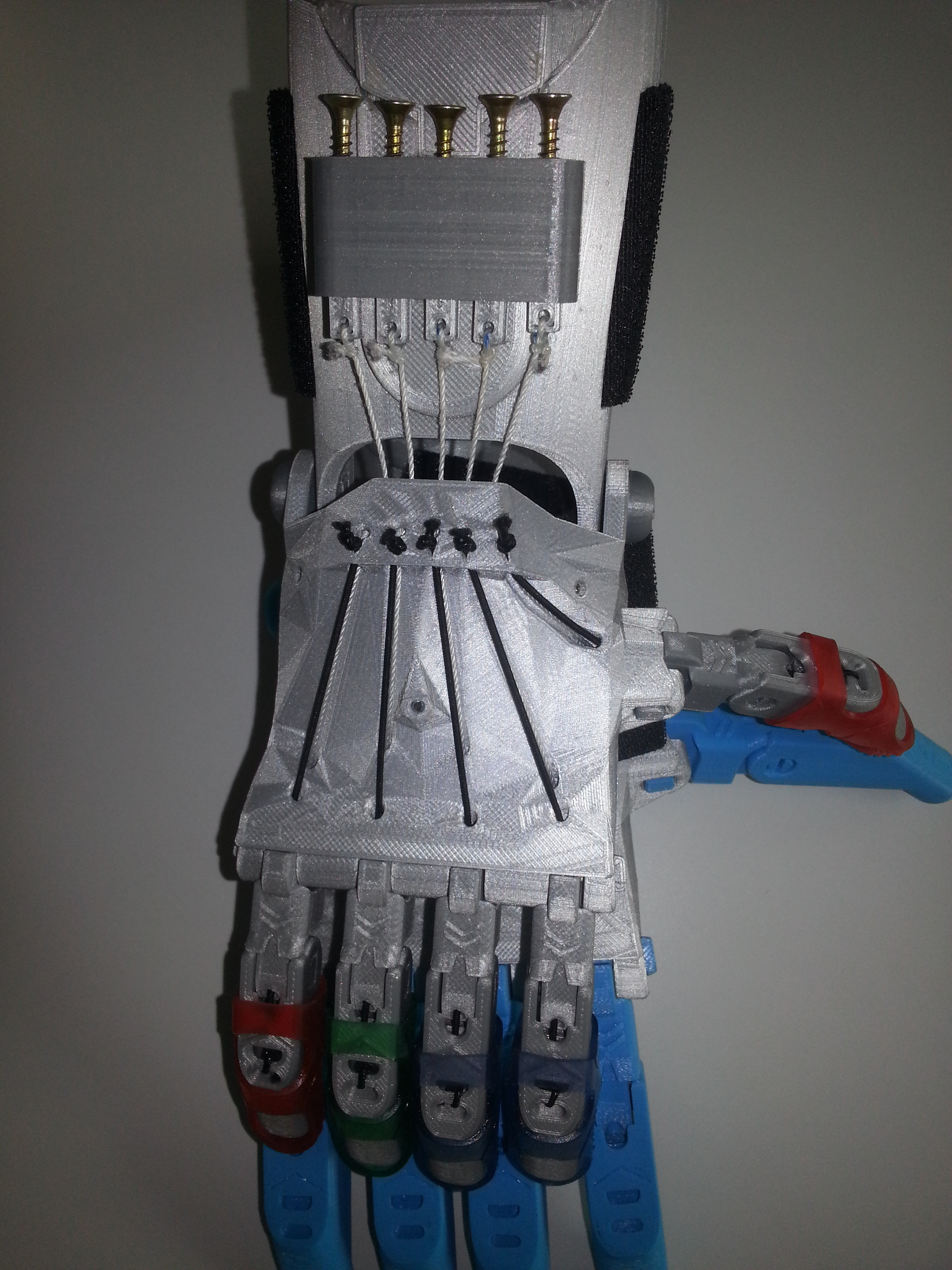

I just printed one last week.
You can put in an order with any local hub. Just ensure they can view the readme file which comes with the zip package from enable. There are specific printer and material settings listed in there.

Any hub can print it, but there is so much more to it.
The hand must be modified for the type of disability, and then modeled in the right size for the recipient.
There are also a lot of parts that need added that are not 3d printed, such as the elastic that holds it together, and the straps, etc.
A local source is definitely needed.

A just get a feedback from another guy saying that the model Raptor is not adapted for my nephew because of the nature of his hand.
But the model Phoenix is more adapted. So, I need someone having already handled those kind of model. It seems to be hard to find it in France/Paris where am living.

Hi, Thank you for answering. I have aleady asked them and sent them the pictures and built the form. Am waiting, there is too many people in the queue… Regards, Zoubir
So what’s the ‘form’ then, an insert inside the prosthetic? Was it ‘Team Unlimbited’ you contacted, because it might be that they just need someone to sort out the CAD design side of things, I’d be happy to facilitate.

All the aspects you’ve pointed out are right and the developpment of my nephew hand is one of them. I expect to ask for new printed hand till he stops growing. Then, I will look for a permanent chirurgical solution option.
But meanwhile, I really need to achieve the 3D part. My request is still in the Enable queue and I have no idea when or where the project will start, there is no visibility about the request and I understand this, since it is a volunteer organization.
So, regarding your last question, I unfortunatly have no one identified to help. I also contacted some “private” organization but none is answering. I would really be happy to help about the total cost required to realize it, but first I need someone to help.
I also got in touch with a guy from Handesign, he was ready to do it, but then realized that he can only make a Raptor design not a Phoenix one.

Enzou3d,
I see you are in New York. But if you are up for it, here is the direction to proceed.
OK, start here.
Contact enablingthefuture, and tell them you want to build the hand for Zoubir. You can also do this in the google+ circle.
Then, read this------
In these comments, you can see the means to measure for the part. It is the same for raptor reloaded as pheonix.----------
And this:
http://www.teamunlimbited.org/the-unlimbited-arm/ 1 which has a spreadsheet for calculating the arm part.
While not exactly the same model, great instructions here:
Source the parts here:
http://shop3duniverse.com/collections/3d-printable-kits/products/raptor-hand-by-e-nable-assembly-materials-kit?utm\_source=eNABLE&utm\_medium=ContentLink&utm\_term=ContentLink&utm\_content=FrontToKitRaptor&utm\_campaign=Campaign101
