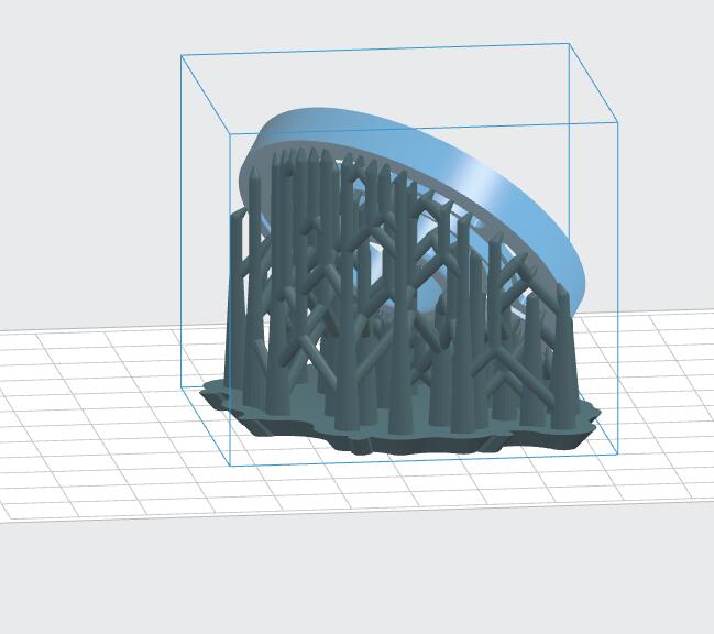

You can check the screenshots below, I let preform to orient my stl file and set the layer height at both 0.05mm and 0.025mm, in additional, I also added some supports based on the auto orientation, but both of them have been failed finally, I don’t know why.
Here are the pictures:

What is the thickness of the walls of your model and how much use is on this particular resin tank?

Yes, I let preform to orient my samples. And i have cleaned the mirrors after every failure, but nothing help.
And I have printed this part with normal resin a few days ago, everything is okay even with the resolution of 0.025 is okay. But When i changed it to tough resin, it fails again and again, I don’t know how to deal with it. I have attached the screenshot of the orientation below, you can check it.

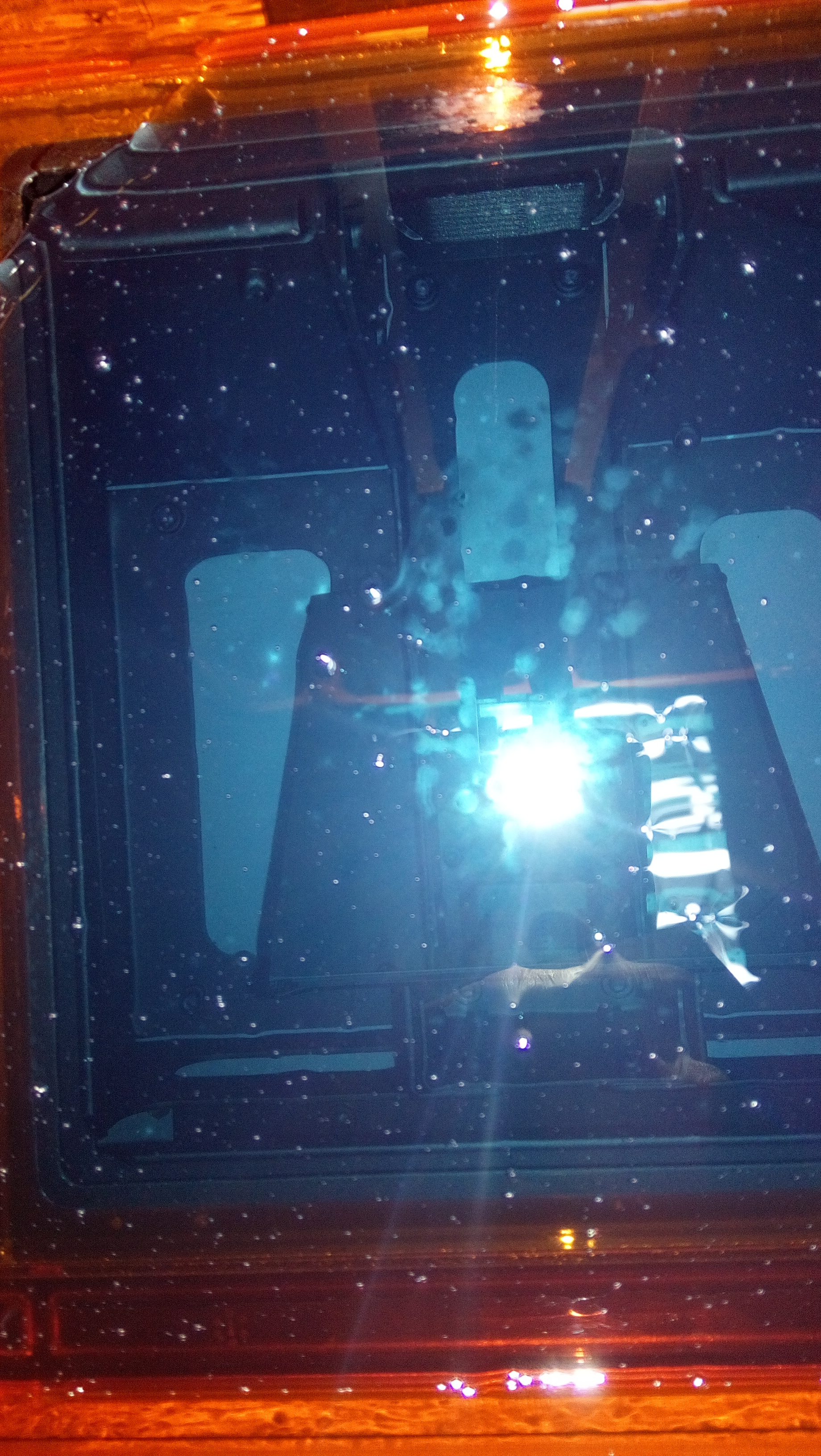

I open the new bottle of resin and pour it into the tank for the first time, I saw some particles in it, here is the picture, I don’t know if it’s normal or not.
I apologize, I do not have Skype, sorry! Ok I think from what I’ve read, it narrows it down to your resin tank and dust on the mirrors. I would follow the Formlabs guide to cleaning all of the mirrors and you will definitely want to start with a fresh resin tank. After a few failures you will most likely have cloudiness in the tank. Also check your date on the back of the resin bottle to assure its not more than a year old.
Sorry I just saw your other pictures, those particles in the resin would definitely have caused your problems ! Anything blocking the laser would cause the issue that you are having. If you just purchased this resin I would contact Formlabs custom service because you may have gotten a bad bottle of resin.

Yeah I find the tough resin is very sensitive to tank cloudiness and mirror / galvo cleanliness. If you contact Formlabs support they’ll give you some things to try which might involve cleaning the mirror surfaces (don’t try any cleaning until you’ve spoken to them though!) Btw if your part has a flat bottom you might be able to get away with printing it flat on the build plate without supports…

Taking a picture with the flash on top of a photosensitive resin is definitely not recommended…
If taken with a phone, it’s a LED flash. It doesn’t emit UV; furthermore, these resins require a lot of UV energy to start the chain reaction. There’s little photoinitiator in these.
Most likely:
- crap in your resin - if these aren’t air bubbles, you need to get rid of these. filter through paper paint strainer, mesh >280 (on ebay for peanuts)
- cloudy tank (but you say no)
- dirty galvo mirrors
- dirty main mirror, or the one under galvos. a little dust makes no difference, but if there’s resin on it, it will make a huge difference.

Hi Winson,
I’d try to print the model without support (it’s flat on one side, isn’t it?).
In my opinion there is not too much wrong with your machine, since the support comes out nice
Have you tried changing the point size of the support? It looks like your support cannot hold the model well, maybe because your point size is relatively small?
