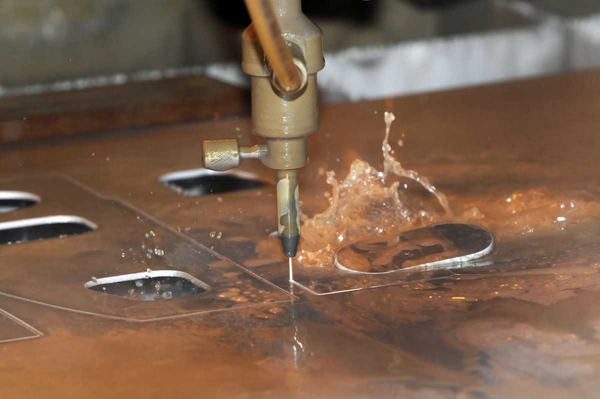

Laser cutting
Laser cutting
This manufacturing process uses a high-power laser beam to cut a material sheet.
  • Allowable sheet thickness: 1-6mm (depending on material)
