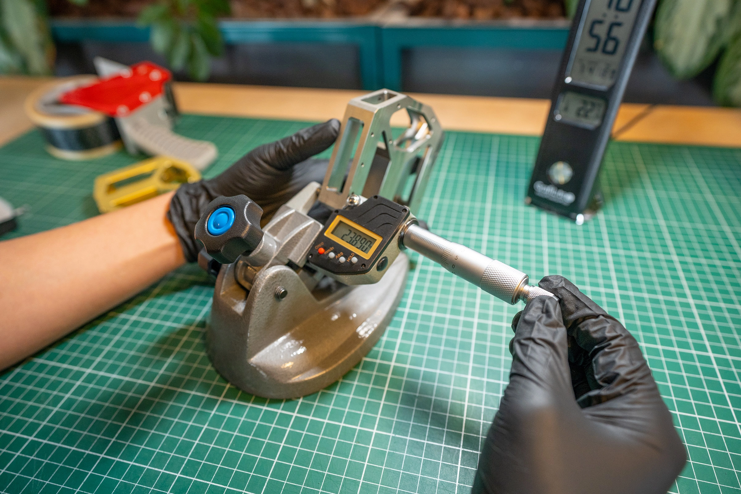

Protolabs Network uses cross-docks as a quality control measure to ensure that parts are up to the Protolabs Network Standard. All orders, no matter where in the world they are manufactured, undergo extensive quality checks by the manufacturing partner after they have been printed, machined, molded or fabricated. In addition to this, many globally produced orders (depending on the complexity of the part and location of production) are then sent to our internal cross-docks in Amsterdam or Chicago for a second inspection before making their way to the customer.
Our cross-docking teams inspect parts visually and dimensionally, checking that they are up to spec, have the intended surface finish, threads and dimensions are as requested, and are correctly packaged. Inspections also verify that parts have not been damaged during transit. Both cross-docks are equipped with state-of-the-art calibrated tools for industrial inspection capabilities.
At Protolabs Network, cross-docking for quality control is an eight-step process.
  • Sample size inspection. Using ISO-2859 general sampling Level I, a sample size of a batch of parts is determined and inspected.
  • Visual inspection for cosmetic quality. A visual inspection is used to observe the surface of an object and look for cracks, scratches, misalignment, corrosion, and other physical defects.
  • Dimensional checks with ISO-calibrated equipment. A dimensional inspection assesses the geometric characteristics of machined parts to verify their compliance with design specifications. It ensures the accuracy of the part’s features that can affect reliability and functionality.
  • FAI (First Article Inspection) with golden samples. Parts are compared with a pre-approved sample to ensure compliance with specifications and quality standards.
  • Full review of official and requested documentation.
  • Compliance and standards review. Parts are given a final check to ensure they meet regulatory standards.
  • Non-conformity reports and follow-up with manufacturers. Any quality issues are documented, after which the manufacturer is contacted to reach a solution.
Packaging checks. Parts are wrapped individually and securely, placed in Protolabs Network boxes, and covered in plastic, to which a shipping label is attached.
