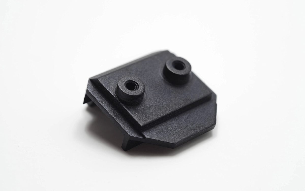

An anodized (Type II) aluminum part, dyed red, with the silver areas masked during anodizing and chrome plating
A close-up of a small aluminum component (approximately 10 mm wide), anodized (Type II) and dyed black
